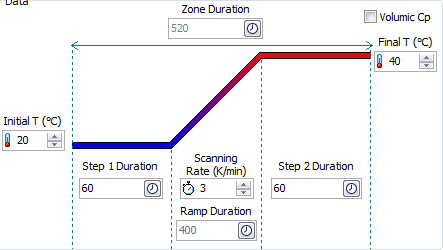

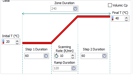

Hello, I have a problem i cant understand and solve. In one previous version we use Gradient of the shape in a TmapSeries (Teechart2013 with delphi XE)
But now the code not work anymore (TeeChart 2015 and delphi 10 Seattle).
You can see exaclly wath i mean in the attached picture.
Here is the code :

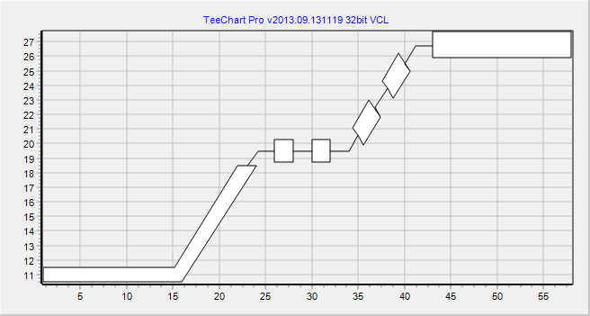

I'm not getting the same result than you with that code, neither with v2013:
testShapes.zip
