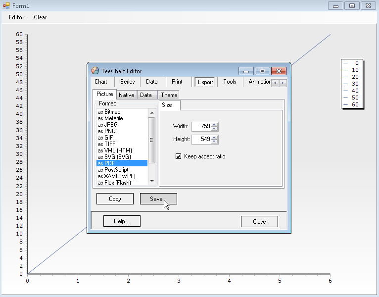

When exporting a simple chart to PDF in the TeeChart Editor, like this:

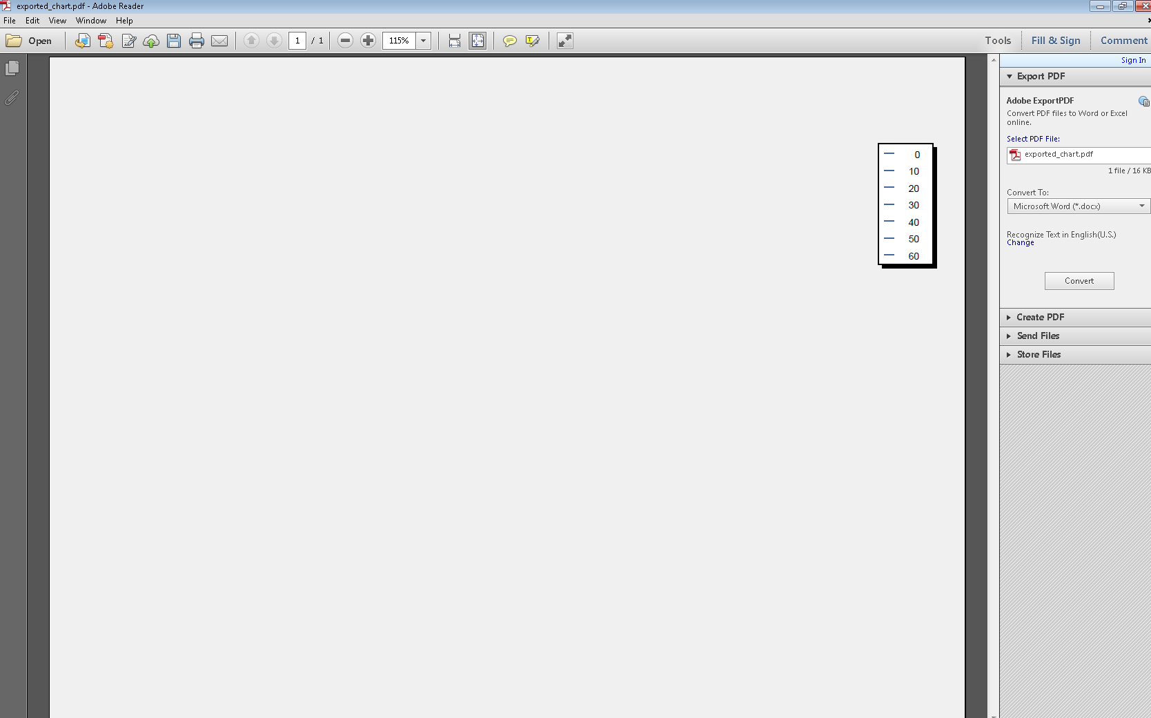

and then opening the exported PDF file in Adobe Reader, I only see the chart legend, but no chart:

Yes - in the release notes for the latest version [here] you can see the ticket at 3) in the list.
