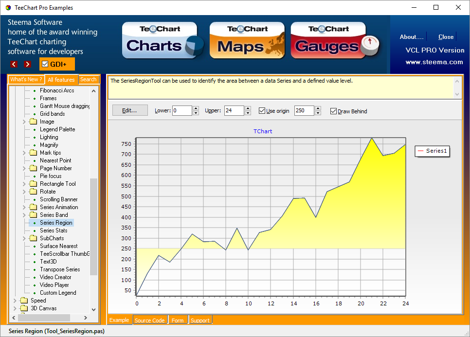

Post by Yeray » Thu Jul 21, 2016 7:41 am
This sounds exactly as what the TSeriesRegionTool does:
The Features Demo and the documentation are shipped with the binary installation.

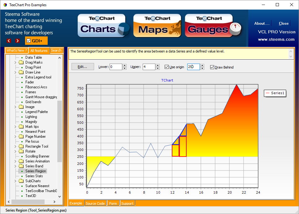

As you can see in the demo, the TSeriesRegionTool has LowerBound and UpperBound. This is X0 and X1 if it is associated to a "vertical" series (it would be Y0 and Y1 if it was associated to a THorizLineSeries ie).
This means you can only set a region with a tool; but you can create as many regions as you wish adding more TSeriesRegionTools.
Ie, taking the example in the Features Demo and playing a bit with the editor:

Post by Yeray » Tue Jul 26, 2016 9:44 am
Have you tried to spit the polygon and calculate the area of the rectangle and the right triangle? Ie:
