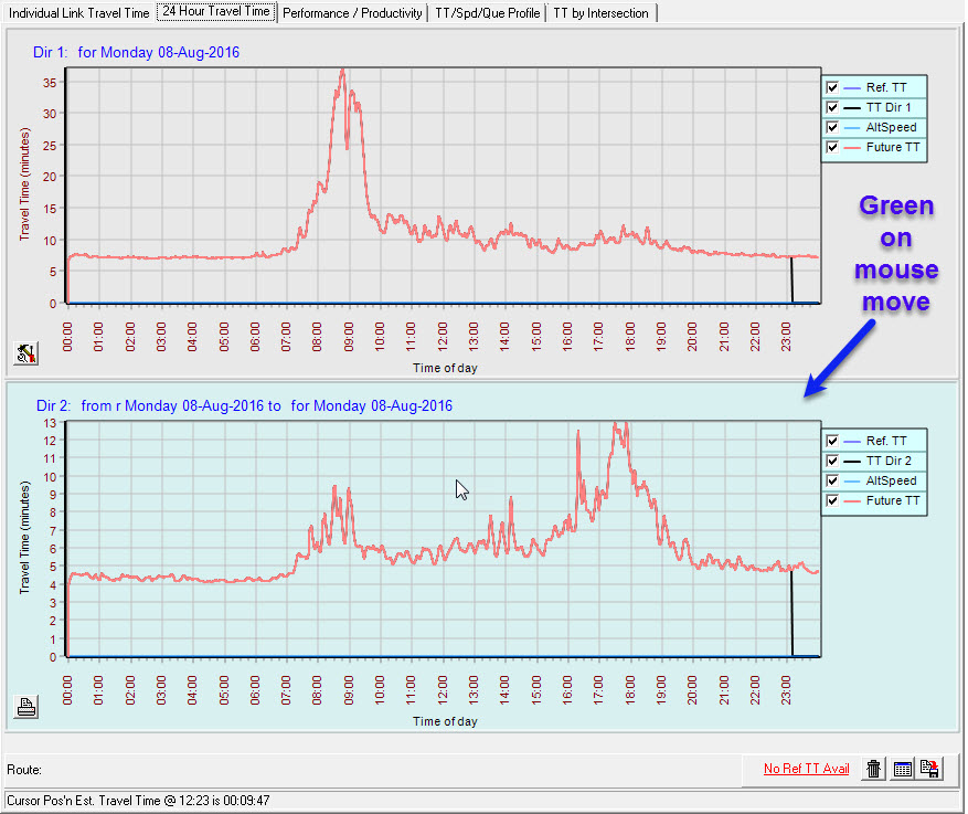

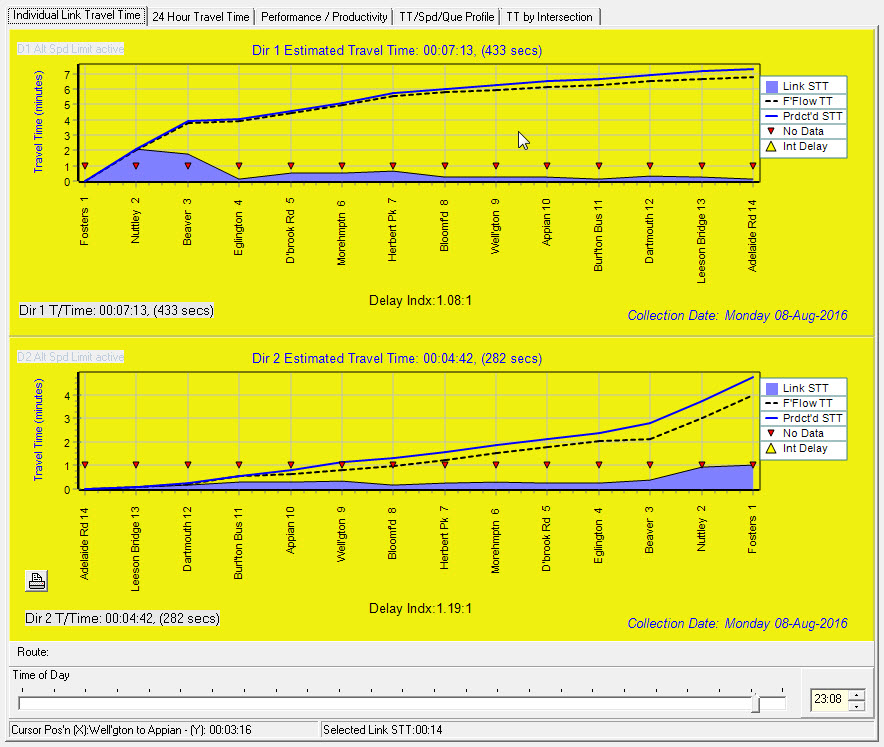

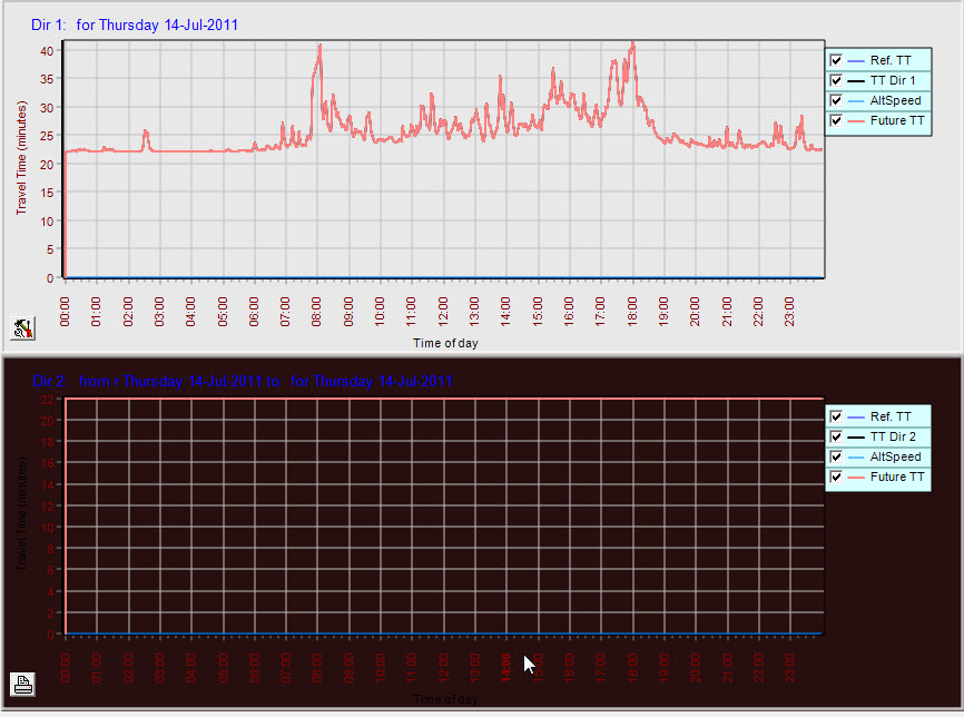

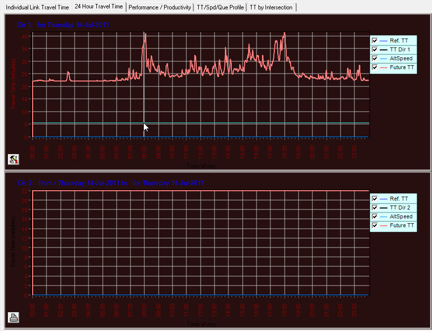

Please see attached images that show what happens to the chart display.
Any ideas what has caused this?

Entire chart colors unexpectedly change

When the mouse was moved over the chart, the charts now went either yellow or pale green:
Incidentally, the code: Pen.Mode:=pmXor; has been there for about 10 years.

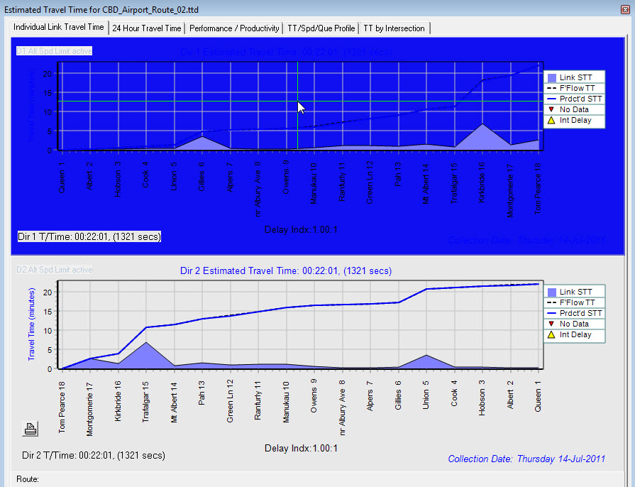

Incidentally, the color change definitely seems to be related to moving the mouse over an adjacent control first, e.g. some text or other graphics object:
