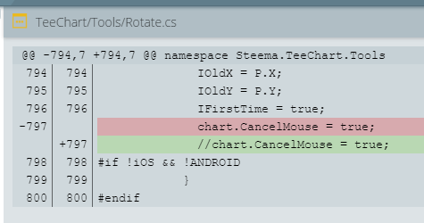

Of course - the change is here:

Post by PidoTech » Thu Jan 26, 2017 5:40 am
Is this issue fixed yet? I want to know if this issue has been fixed.
Re: Rotate does not work with Legend Checkboxes
Post by Christopher » Thu Jan 26, 2017 12:12 pm
PidoTech wrote:Is this issue fixed yet? I want to know if this issue has been fixed.
Yes, that change is in the last publicly available release - ID1612 here.
