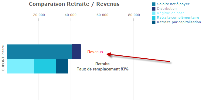

Hello again ;)
A simple question, but I can not find the answer.
How to change the color of a text TSeriesMarks when flying ?
In this example, I want to change the color of the word "Revenus". I don't want it to be red.
The TSeriesMarks has no Selected or Hover property. How to do ?
Thank you for your reply.

Are you looking for this?
  Series1.Selected.Hover.Font.Color:=clGreen;

Hello.
That's right. I was looking for the solution in TSeriesMarks :(
