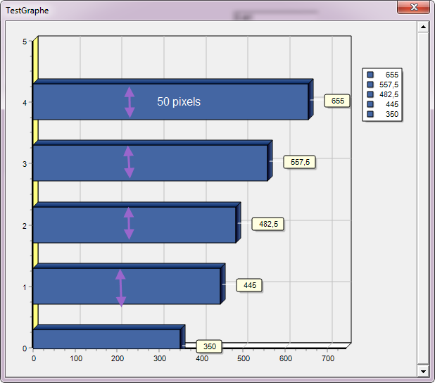

When my series is composed of 5 values (FillSampleValues (5)), I get this...

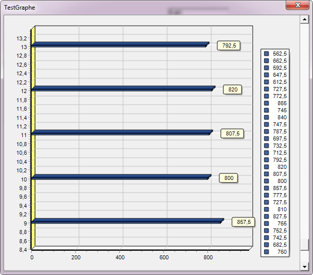

When my series is composed of 100 values (FillSampleValues (100)), I get this...
Since Chart1-> LeftAxis-> Maximum is always 5, I would like that in both cases, my bars have the same width.
In my example, with 100 values, the bars are very small whereas there is ample room to display them. He pretends to put all the bars on a single page.
What should be done ?

Try setting your bar series AutoBarSize property to true:
  THorizBarSeries *horizBar1 = new THorizBarSeries(Chart1);
  Chart1->AddSeries(horizBar1);
  horizBar1->FillSampleValues(20);
  horizBar1->AutoBarSize=true;

Thanks, this solution works
