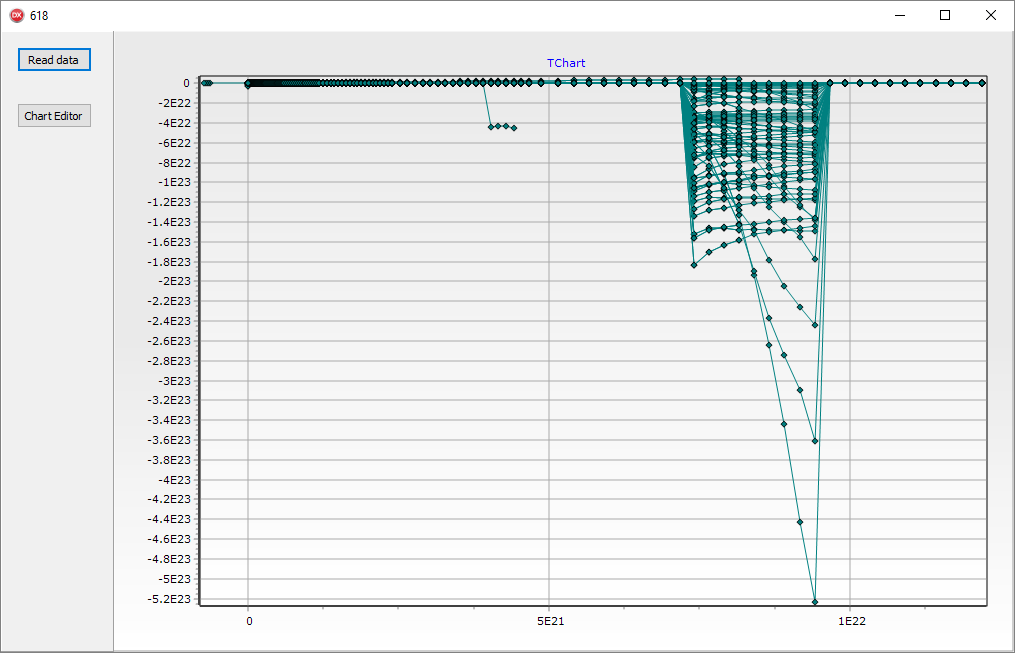

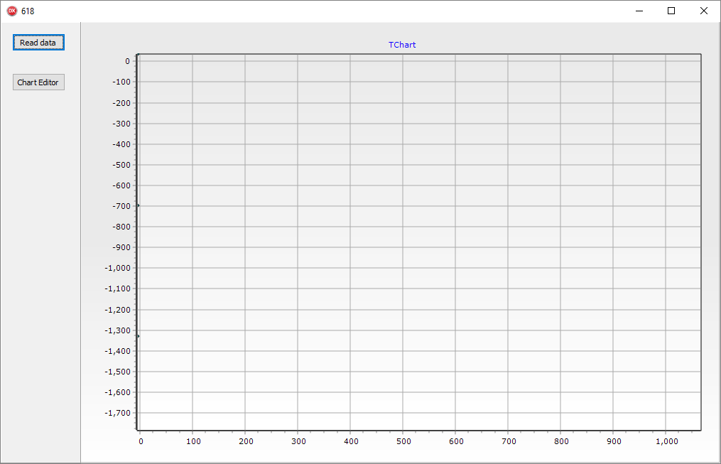

Here my tests with RAD Studio 10.1 Berlin Update 2 in a Windows 10 x64, but always compiling against Win32 target platform:
- Using TEEVALUEDOUBLE (default) define in v2016.19 and defining F_XArray and F_YArray as array of array of single (as it is in your application):
Works fine for me here:
Changing F_XArray and F_YArray to array of array of TChartValue in your application gives the same result.
- Using TEEVALUESINGLE define in v2016.19 and defining F_XArray and F_YArray as array of array of single (as it is in your application):
Doesn't crash, but gives me a strange result:

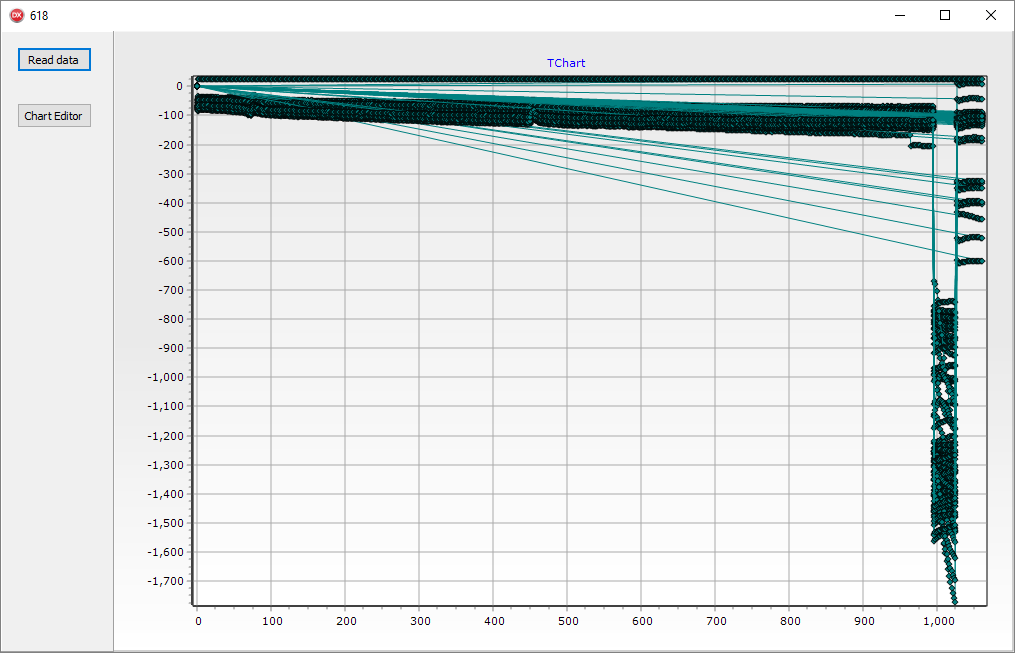

- Using TEEVALUEEXTENDED define with the current sources and defining F_XArray and F_YArray as array of array of single (as it is in your application):
Crashes at the TChartValueList.RecalcStats method in VCLTee.TeEngine.pas.
Changing F_XArray and F_YArray to array of array of TChartValue in your application works fine for me here, giving a different result than the result obtained using TEEVALUEDOUBLE above:
Could you please explain what result would you expect to obtain?

The last graph is the graph is the result we expect to obtain.
The first graph is the result if you assign a doubles array to a singles ChartValues in lines 104 and 108 of the program
104      Chart_Test.Series[iSerie].XValues.Value    := TChartValues(F_XArray[iSerie]);
105      Chart_Test.Series[iSerie].XValues.Modified := True;
106     Chart_Test.Series[iSerie].XValues.Count    := ValueCount;
107
108      Chart_Test.Series[iSerie].YValues.Value    := TChartValues(F_YArray[iSerie]);
109      Chart_Test.Series[iSerie].YValues.Modified := True;
110      Chart_Test.Series[iSerie].YValues.Count    := ValueCount;
This is intended to point the X/YValues.Value array of the series to the pointer of the 2 dimensional array by iSerie
So if you have Singles array values pointing to double Chart values then you get a mismatch of points resulting in graph 1.
The graph 2 gives the same result as on my pc. The error occurs if I resize the form.
