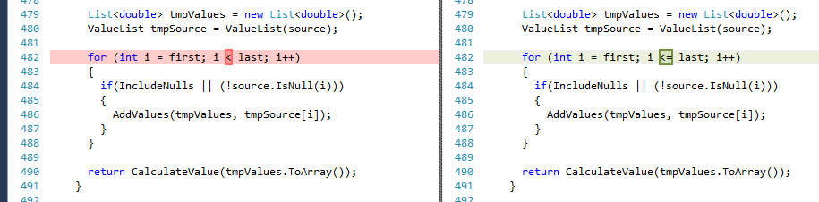

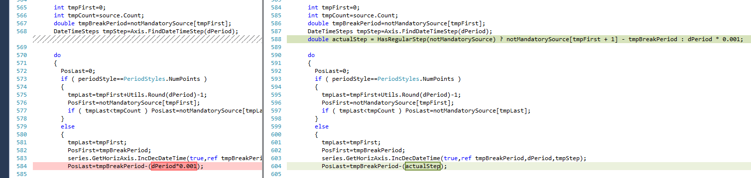

Post by Christopher » Tue Jan 17, 2017 11:27 am
Unfortunately there were two defects in this area of code which have now been fixed and will be available in the next maintenance release. However, these fixes can be used now in a custom Add function class like this:

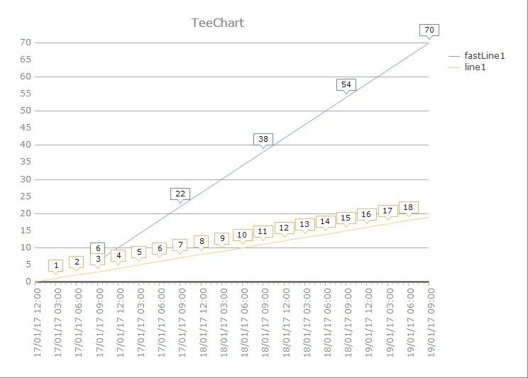

This class can be used as following:
    Line series;
    FastLine funcSeries;
    MyAdd chartTotalFunction;
      funcSeries = new FastLine(tChart1.Chart);
      funcSeries.Marks.Visible = true;
      chartTotalFunction = new MyAdd();
      chartTotalFunction.Period = new TimeSpan(0, 12, 0, 0).TotalDays;
      chartTotalFunction.PeriodAlign = Steema.TeeChart.Functions.PeriodAligns.Last;
      chartTotalFunction.PeriodStyle = Steema.TeeChart.Functions.PeriodStyles.Range;
      funcSeries.Function = chartTotalFunction;
      series = new Line(tChart1.Chart);
      DateTime today = DateTime.Today;
      for (int i = 0; i < 20; i++)
        series.Add(today, i);
        today = today.AddHours(3);
      series.Marks.Visible = true;
      funcSeries.DataSource = series;
      tChart1.Axes.Bottom.Increment = new TimeSpan(0, 3, 0, 0).TotalDays;
      tChart1.Axes.Bottom.Labels.DateTimeFormat = "dd/MM/yy hh:mm";
which gives me this chart:
The above chart is now correct. Can I help you with any specific questions you may have with this?

Of course. The changes are in Functions/Basic.cs:
You already have the code for HasRegularStep().

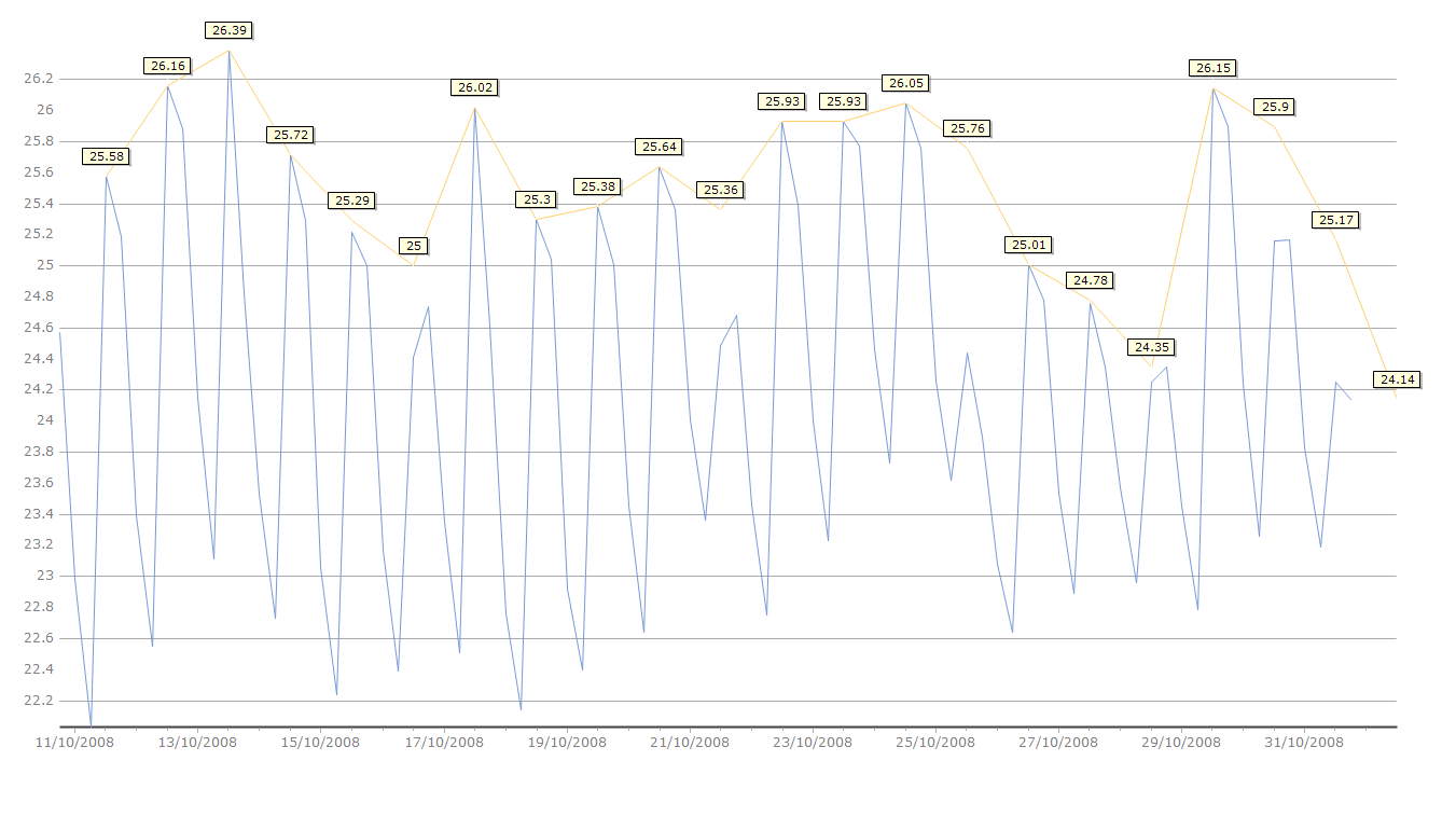

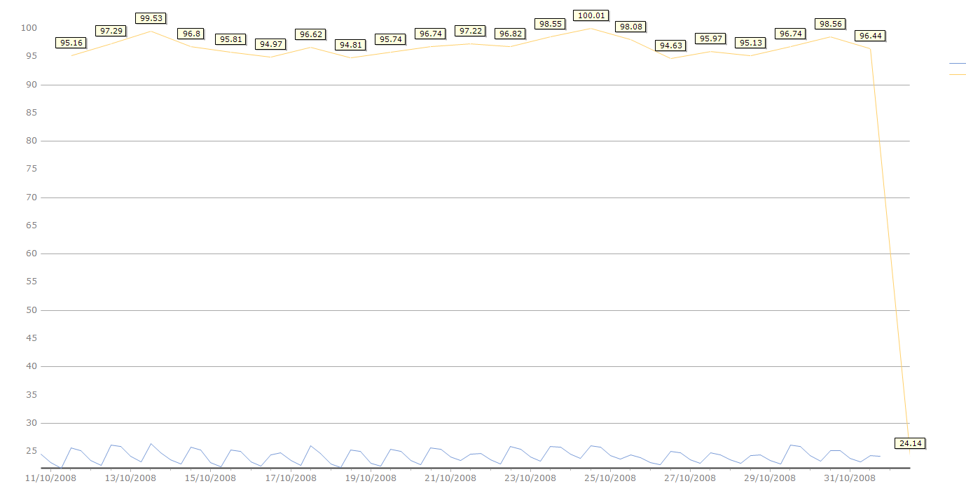

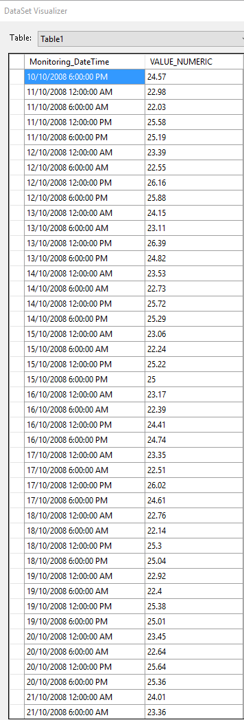

Thanks for the code, we have updated the basic.cs accordingly but the results are still incorrect.
It skips values for the first day which has only 1 row.
Screenshot for sample data
Sample data for the series
We are using with chart max and total functions.
Output for total function:
total function
Output for maximum function:
The results are correct when the subset of data for each day has the same number of data/ same interval (i.e date/time)

We handle mostly time series data for which we need to be able to apply periodic functions. I am trying to make it simple and straight.
The forum does not allow adding text files, so I've sent the data into a .txt to your gmail address. Please use the text file to load the data for the series.
To reproduce the issue, first add a series in run time (it can be done using code too):
1. From the Chart editor, add a new series (i.e: RawDataSeries).
2. Under series Tab's General Tab, set the Horizontal Axis to Bottom and check Date Time checkbox (this is another bug as the date/time field is not recognized automatically, it throws an exception if not set manually)
3. Now under the series tab, click on Datasource, select text file
4. For the file attached here, under fields tab use Number of Header lines: 1, Separator: Tab, X: 0, Y: 1
5. Specify the file location, hit apply to populate the series
Now use the code that I have posted at the beginning. Please note the period we are using is One day and therefore the period = New TimeSpan(1, 0, 0, 0)
The total value should output individual total day's not on a 24 hours basis day. This does not work. In-fact, none of the function series' value for one day period is correct for the data given.
Hope that helps

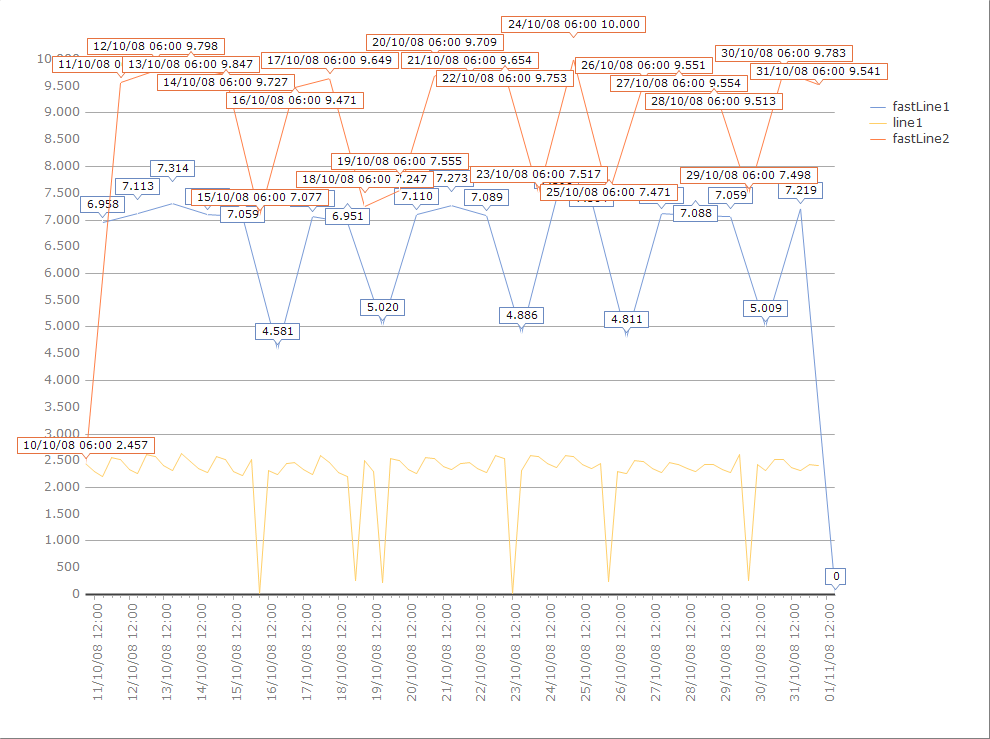

Post by Christopher » Thu Jan 26, 2017 5:26 pm
Seveno Developer wrote: The total value should output individual total day's not on a 24 hours basis day. This does not work. In-fact, none of the function series' value for one day period is correct for the data given.
Hope that helps
I think the issue here is that you are expecting the function to group points by Date, whereas what they are doing is by PeriodStyles.Range, that is, the points that fall within a one day Period (in this case). Maybe the difference can be seen in this example:

which gives me this:
In funcSeriesLINQ we group the data by the Date, that is, by a one day (24 hour) period whereby all points are of the same day. The funcSeries, on the other hand, groups points into one day periods but not of the same day, because the first point does not start at 00:00. This is by design, although maybe not what you were expecting.
Thanks Christopher, the issue is as you pointed it correctly, the first point does not start at 00:00. I have added an overloading function to the datetime increment which solves our problem.
