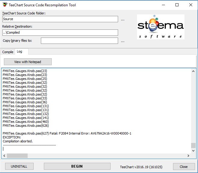

Hi again!
This time I tried to run as administrator the TeeChart Recompilation tool as you proposed.
The error is still visible.
Check the image below.
error
Regarding the source files , we have not modified anyone ad to be sure we run the process in another laptop (second license) and still the same.

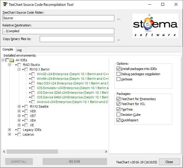

I could reproduce the fatal error you are reporting selecting "Debug packages compilation".
I found another error arises if you select "Decision Cube".
We'll investigate these problems.
