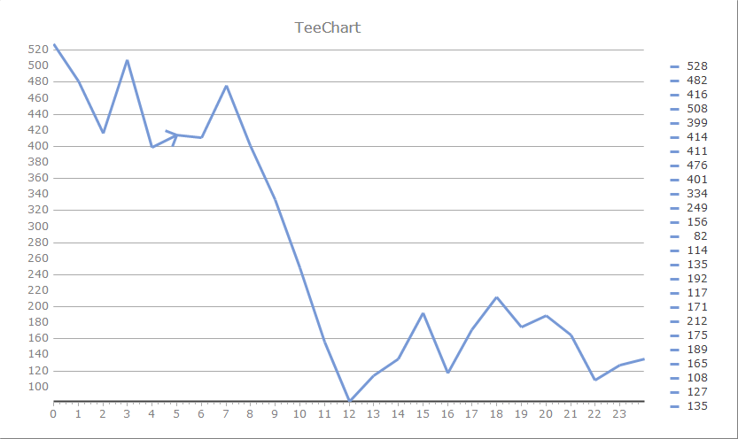

possibly the easiest way to achieve this would be to custom draw an arrow onto the TeeChart canvas - this can be done using one of the TeeChart events and the canvas Arrow method, as in this example:
    Line line;
      line = new Line(tChart1.Chart);
      line.FillSampleValues();
    private void TChart1_AfterDraw(object sender, Graphics3D g)
      int x = line.CalcXPos(5);
      int y = line.CalcYPos(5);
      Point from = new Point(x - 25, y);
      Point to = new Point(x + 25, y);
      g.Brush.Color = line.Color;
      g.Arrow(true, from, to, 25, 25, 0);
is this a satisfactory solution for you?

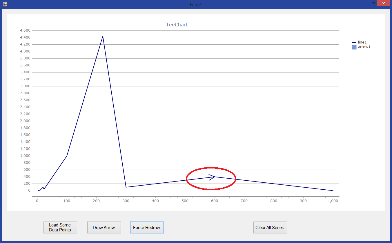

Thank you Christopher. I have tested the implementation. The g.Arrow is much larger than what is needed.
I have attached a screen capture of the desired look. The added arrow head is inside the red circle. Generally, the arrow head looks like two lines at the correct orientation relative to the line segment slope. The line and arrow series' widths are the same.
Note that I have to force the TeeChart.Invalidate() method to be called twice to render the arrow series' single point. The two Invalidate() invocations occur regardless of using the Graphics3DDirect2D object. When the line series is added, a single Invalidate() call renders the new line. Nearly all TeeChart properties are the default values. Is there a property value I need to set differently in the Windows Form constructor, after the .Net InitializeComponent method returns?

Well, another alternative is to draw your own arrows - this simple example draws an arrow orientated along the vector to the specified series point (AtPoint) from the previous series point (AtPoint - 1):
    Line line;
      line.LinePen.Width = 3;
      Action<int, int> Arrow = (AtPoint, Size) =>
        Point to = new Point(line.CalcXPos(AtPoint), line.CalcYPos(AtPoint));
        Point from = new Point(line.CalcXPos(AtPoint - 1), line.CalcYPos(AtPoint - 1));
        Point difference = new Point(to.X - from.X, to.Y - from.Y);
        double tmp = Math.Sqrt(Math.Pow(difference.X, 2) + Math.Pow(difference.Y, 2));
        PointF vector = new PointF((difference.X / (float)tmp), ((difference.Y / (float)tmp)));
        PointF perpendicular = new PointF(vector.Y, -vector.X);
        Point online = new Point(Utils.Round(to.X - Utils.Round(vector.X * Size)), Utils.Round(to.Y - Utils.Round(vector.Y * Size)));
        Point topleft = new Point(Utils.Round(online.X - Utils.Round(perpendicular.X * Size)), Utils.Round(online.Y - Utils.Round(perpendicular.Y * Size)));
        Point bottomleft = new Point(Utils.Round(online.X + Utils.Round(perpendicular.X * Size)), Utils.Round(online.Y + Utils.Round(perpendicular.Y * Size)));
        g.Line(topleft, to);
        g.Line(bottomleft, to);
      g.Pen.Color = line.Color;
      g.Pen.Width = line.LinePen.Width;
      Arrow(5, 10);

Thank you again, Christopher.
Your first approach is what is in use now. The zooming in and out scaling works best with that. The initial rendering zoom setting is set such that the user will see the double line style in the first example. If the user zooms in for a close up view, the arrow expands to the larger style. It turns out that that automatic response helps our end users the most.
Sincerely,
