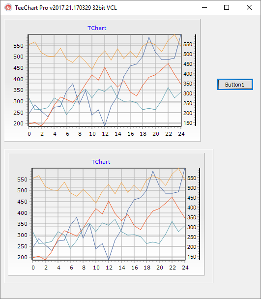

It seems to work fine for me with v2017.21 here.
testCBuilderImport.zip
(85.97 KiB) Downloaded 1159 times
