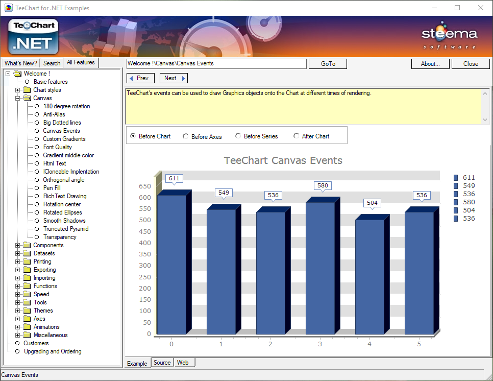

Custom axes do not automatically reposition on every Chart repaint, for example when you cause a repaint by resetting the MarginLeft property. This means that the custom axes positions have to be calculated for each repaint, something you can achieve in one of the Canvas paint events:
