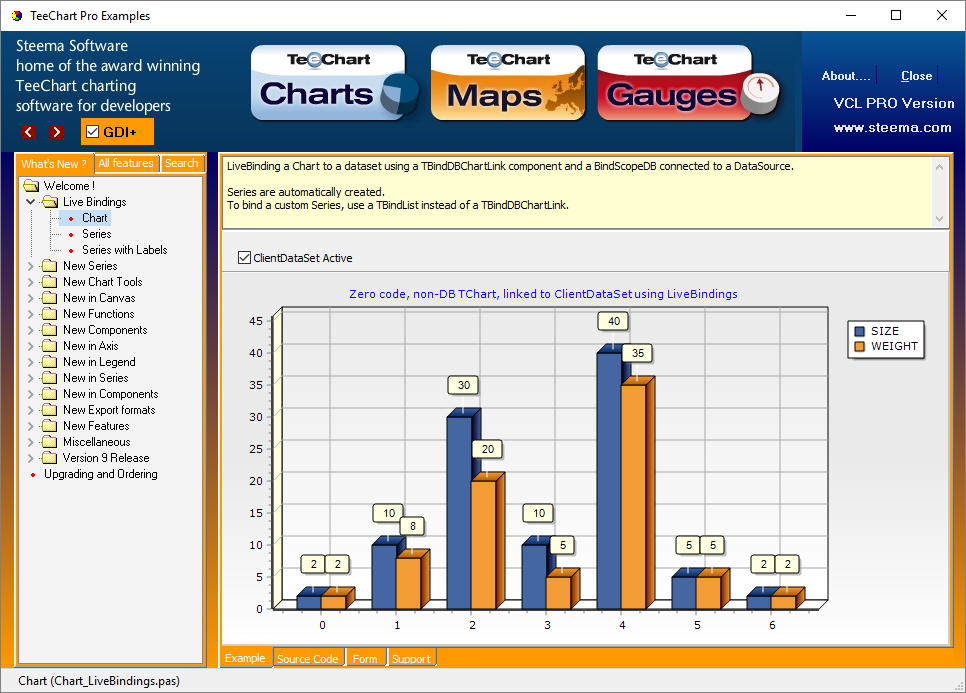

TeeChart already supports LiveBindings at design-time. See the examples in the features demo under "Live Bindings":

Yes, I wasn't asking about support for it - I'm asking to turn it off by default for VCL. The problem is for very large projects, the LiveBindings that is linked to TeeChart causes MASSIVE slowdown when opening a Delphi project form the first time in the IDE.
You addressed before with this link:
viewtopic.php?f=3&t=16481
Your fix disabled the requirement for LiveBindings. You actually sent me a "non-source" version to get it going, but I had issues. I can try again, however I was just wondering if the latest release handles this now (As it was just a day or so after our conversation on this)

We added a checkbox to remove LiveBindings support from TeeChart packages in TeeRecompile. So this option is only available for the Source Code customers for the moment but we'll send compilations to non-source code customers on demand, like you. And we'll rethink on that if the demand is big.
