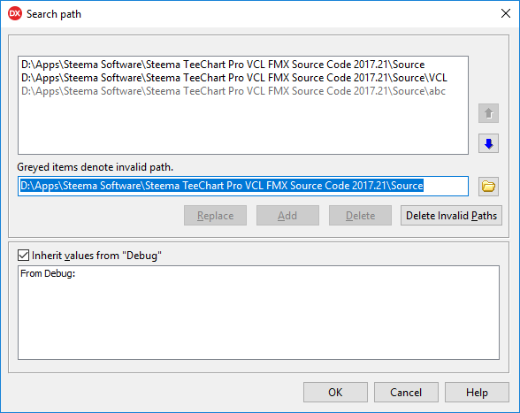

As a check, please add the TeeChart 'source' and 'source\vcl' folders to the project options 'search path' and confirm that the paths to the sourcecode are reported in hard-black in the browser list where you have them selected. ie. that Delphi recognises the paths (rather like the difference between good & bad path in the attached image).
