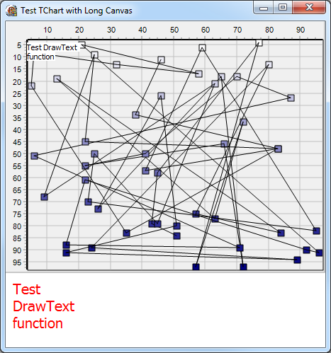

Since i've upgrade my RAD from D2009 to XE10.1 and Teechart from 8.08 to 2017.10, DrawText function (from winapi unit) no longer use canvas settings as font color, size, etc...
Same function on TImage canvas works fine!
Please find attached small project highlighting problem.
I use Delphi XE10.1 and TeeChart Pro VCL FMX Source Code 2017.20.
Thanks for your help
Anthony
TestTChartLDrawText - XE10.1.zip
(25.96 KiB) Downloaded 1469 times

It works as always if you switch back from GDIPlus to GDI:
uses TeCanvas;
  Chart.Canvas:=TTeeCanvas3D.Create;

We don't have this listed to modify for GDI+. There is the alternative approach using TeeChart's own TextOut.
eg.
Chart.Canvas.Font.Color := clred;
  Chart.Canvas.Font.Size := 15;
  Chart.Canvas.TextOut(r.Left,r.Top,str);
You'd need to add some code to divide up your lines at the spaces.
