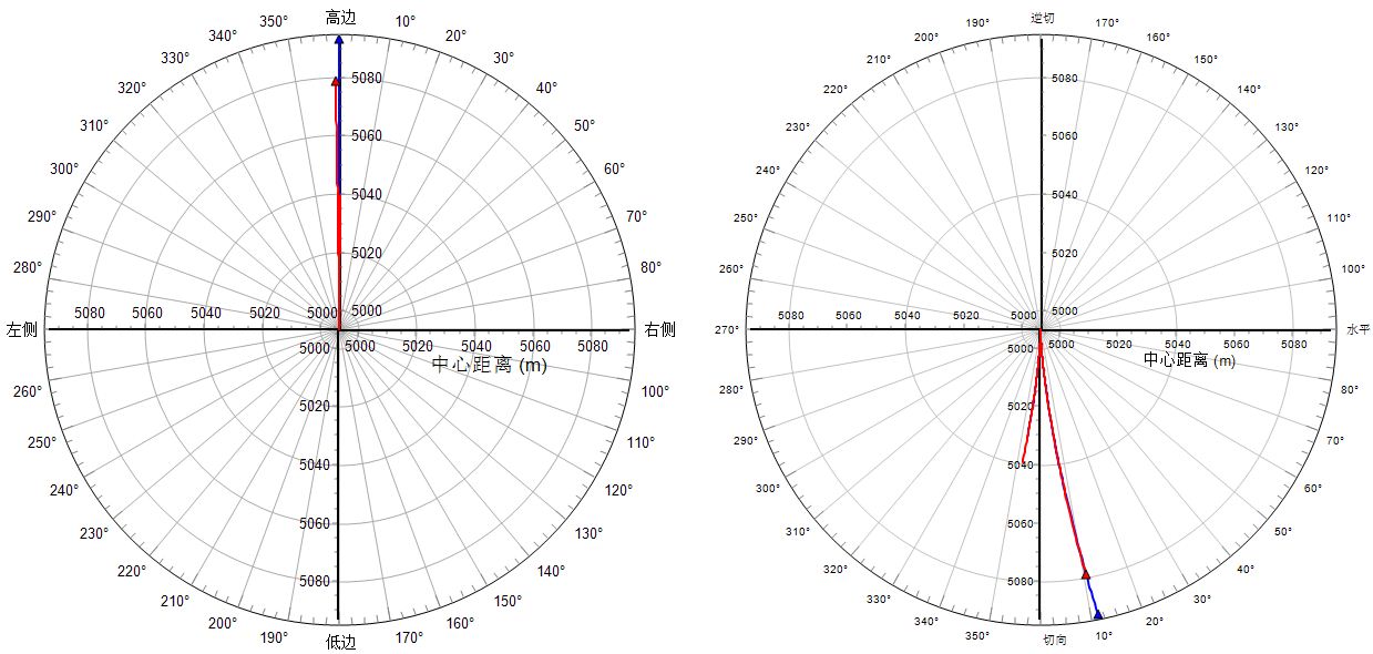

To draw two PolarSeries Charts, and using TSubChartTool draws the second Chart. The two Charts (named TheChart and SubChart) have the same sizes and arrange horizontally (see the Fig. attached).

However, the Fonts of Axes’s Titles and Labels appears differently. Why is that?

But, the number of the circle grid lines of the two Charts are different.
I understand that the increment is calculated automatically according the space there is to draw labels, it depends always from size of chart.
In this case, the sizes and axes properties of the two Charts should be the same, why are the numbers of the circle grid lines of the two Charts are different?
I guess that there must be something different except Axes’s Increment and LabelsFont. i.e. Label Margin, Separation, etc. How to solve this problem?

Difficult to say without reproducing the issues here.
Could you please arrange a simple example project we can run as-is to reproduce the problems here?
Have you tried using two independent TCharts instead of using a TSubChartTool?
