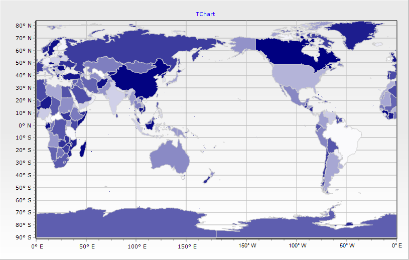

How can I use the TWorldSeries for a Pacific centered map, so that it uses 0 to 360 degrees instead of -180 to +180 degrees?

You could use two TWorldSeries. The first one to draw from 0 to 180 and the second one to draw from -180 to 0. Ie:
uses TeeWorldSeries;
var Series1: TWorldSeries;
var tmpSeries: TWorldSeries;
  Chart1.View3D:=False;
  Chart1.Legend.Hide;
  Series1:=Chart1.AddSeries(TWorldSeries) as TWorldSeries;
  Series1.FillSampleValues();
  with Chart1.Axes.Bottom do
    EndPosition:=50;
    SetMinMax(0, 180);
  tmpSeries:=CloneChartSeries(Series1) as TWorldSeries;
  with Chart1.CustomAxes.Add do
    Horizontal:=True;
    StartPosition:=50;
    SetMinMax(-180, 0);
  tmpSeries.CustomHorizAxis:=Chart1.CustomAxes[0];
  tmpSeries.ParentChart:=nil;
  Chart1.AddSeries(tmpSeries);

How can I add a shortest distance line from a position in Australia to a position on the west coast of the US, for example from Sydney to San Francisco, using this Pacific centered map?
Posts: 9674
Re: TWorldSeries - Pacific centered map
Post by Yeray » Wed Jun 13, 2018 1:27 pm
Do you mean how to calculate the great-circle distance or do you mean how to choose between the distance of two points in the same series or from a series to the other? For the later, once you have both distances you only have to take the shortest.
