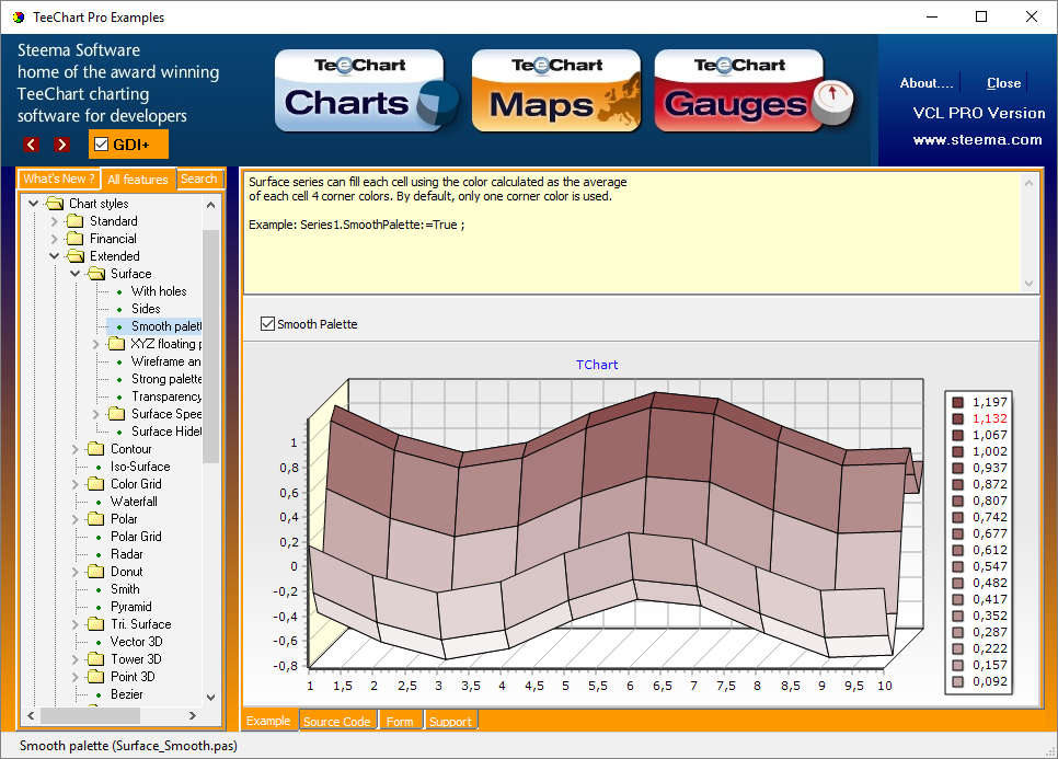

Here how the "Surface_Smooth" example looks by default using GDIPlus:
Changing the Canas to OpenGL from the status bar contextual menu also changes the zoom. Is this what you mean?

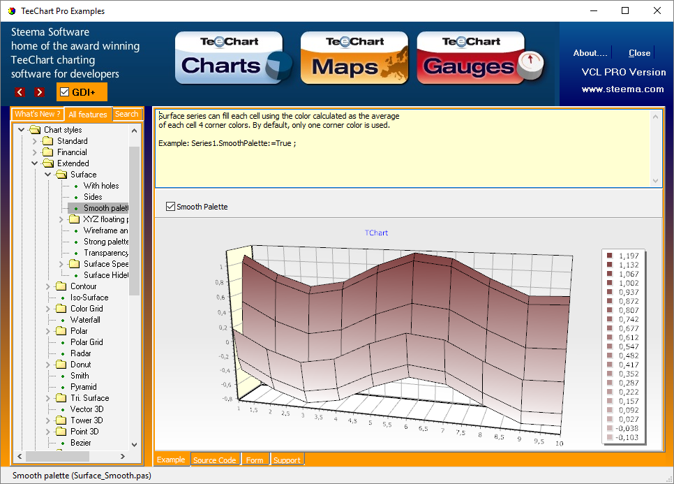

However, if you change the Canvas from the "Chart\3D\Render" tab, and you unselect "Orthogonal" checkbox from the "Chart\3D\Options" tab, it looks much better:

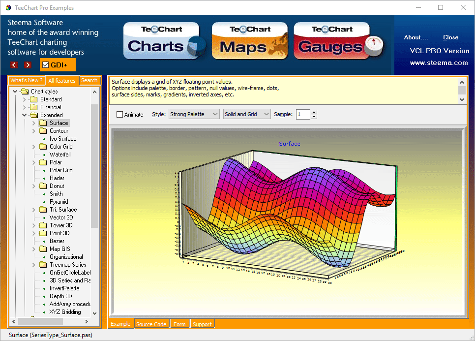

Using the "SeriesType_Surface" example, by default you can see these Aspect settings:

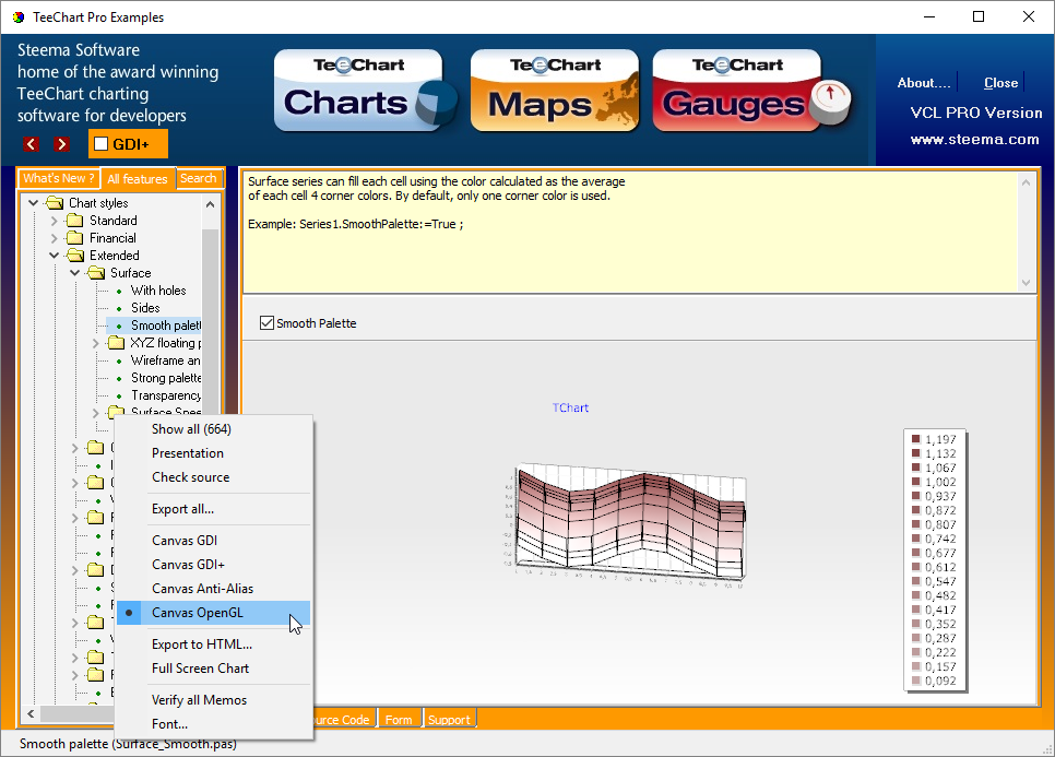

Changing to OpenGL using the contextual menu, it changes the Zoom:

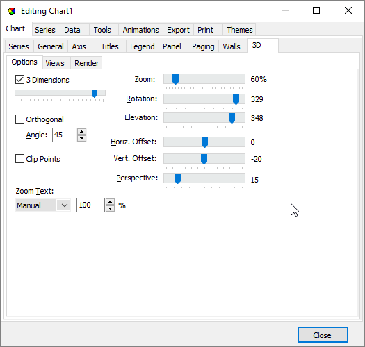

If, instead of using the contextual menu, you change to OpenGL through the Editor, nothing else is modified and it looks good:
