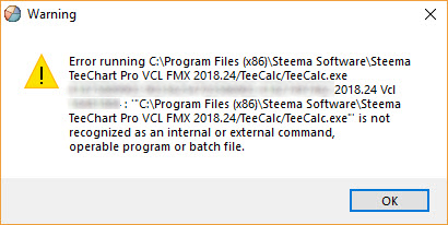

I am installing TeeChart VCL v2018.24 on a Windows 10 (v1803) machine and get the following error message after entering my Licence Number and Password (which is valid until 03 Oct 2018):

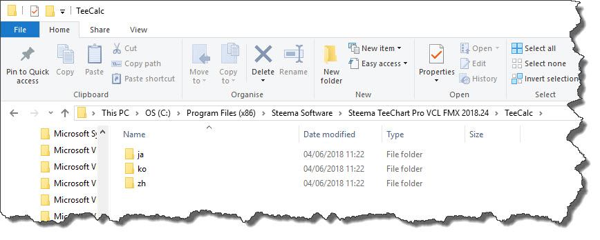

When the installation fails, the directory structure in C:\Program Files (x86)\Steema Software looks like this:
