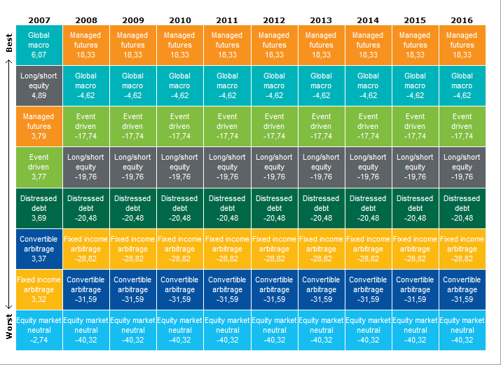

Hi, can Teechart be used to create a "chart" like the image below? Basically just a series of squares with different colors and sorted by a specific value. I'm using Teechart 8.
Thanks in advance for any pointers.

Here a simple example using TBarSeries:

This is how it looks with TeeChart v8:
However, resizing the Chart also resizes the squares to rectangles. This isn't a trivial feature.

      X0:=TMyShape(myShapes.Items[i]).Year-0.5;
      X1:=TMyShape(myShapes.Items[i]).Year+0.5;
      Y0:=MaxValueForYear(TMyShape(myShapes.Items[i]).Year);
      Y1:=Y0+1;
Other than years I might show monthly data (e.g. Jan to October), or 3-year periods (2000, 2003, 2006 etc), how would I then need to change the X0/X1 values? (are those coordinates within the chart?)
Posts: 9674
Re: Chart possible with Teechart?
Post by Yeray » Thu Jul 05, 2018 7:22 am
vinc64 wrote:Other than years I might show monthly data (e.g. Jan to October), or 3-year periods (2000, 2003, 2006 etc), how would I then need to change the X0/X1 values? (are those coordinates within the chart?)
Yes, they are values in the axis scale.
Note the labels in the top axis are directly showing the axis values. I populate the shapes with "X0:=Year-05" and "X1:=Year+0.5" to have those Years in the Top axis.
If you want to show months, you could store them also as integers, populate the shapes with Month-05 and Month+05 and then use the OnGetAxisLabel event to convert those values to month names. Something like this:
procedure TForm1.Chart1GetAxisLabel(Sender: TChartAxis; Series: TChartSeries;
  ValueIndex: Integer; var LabelText: string);
  if (Sender = Chart1.Axes.Bottom) then
    ValueIndex:=StrToIntDef(LabelText, -1)+1;
    if ValueIndex>0 then
       LabelText:=LongMonthNames[ValueIndex mod 12];
Regarding "3-year periods (2000, 2003, 2006 etc)", you could still store the Year and then populate the shapes with "X0:=Year-1.5" and "X1:=Year+1.5".
