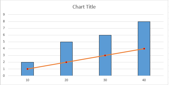

I need below type chart with 2 series bar and line.
I have fixed 6 point for line series and fix 6 bars but not able to generate plot like above image.

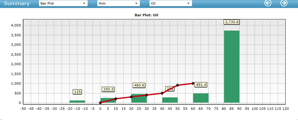

I have getting results like below image.
Please help me.

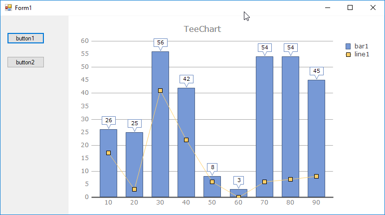

this code:
			Bar bar = new Bar(tChart1.Chart);
			line.Pointer.Visible = true;
			line.Pointer.InflateMargins = false;
			bar.Marks.Style = MarksStyles.Value;
			Random rnd = new Random();
			for (int i = 10; i < 100; i+=10)
				int y = rnd.Next(100);
				bar.Add(y, i.ToString());
				line.Add(rnd.Next(y));
here gives me the following chart:
Re: Regarding Bars and line plot issue
Post by Christopher » Mon Jul 09, 2018 4:11 pm
The same result can be obtained using this code:
				bar.Add(i, y);
				line.Add(i, rnd.Next(y));
giving me here:
