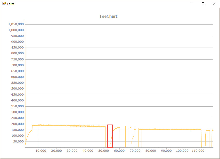

I tested this function using one of our actual data sets containing 100000+ points in a single series. Here is the full data set that has been downsampled to 5000 points. It appears to have been correctly downsampled and achieves our goals:

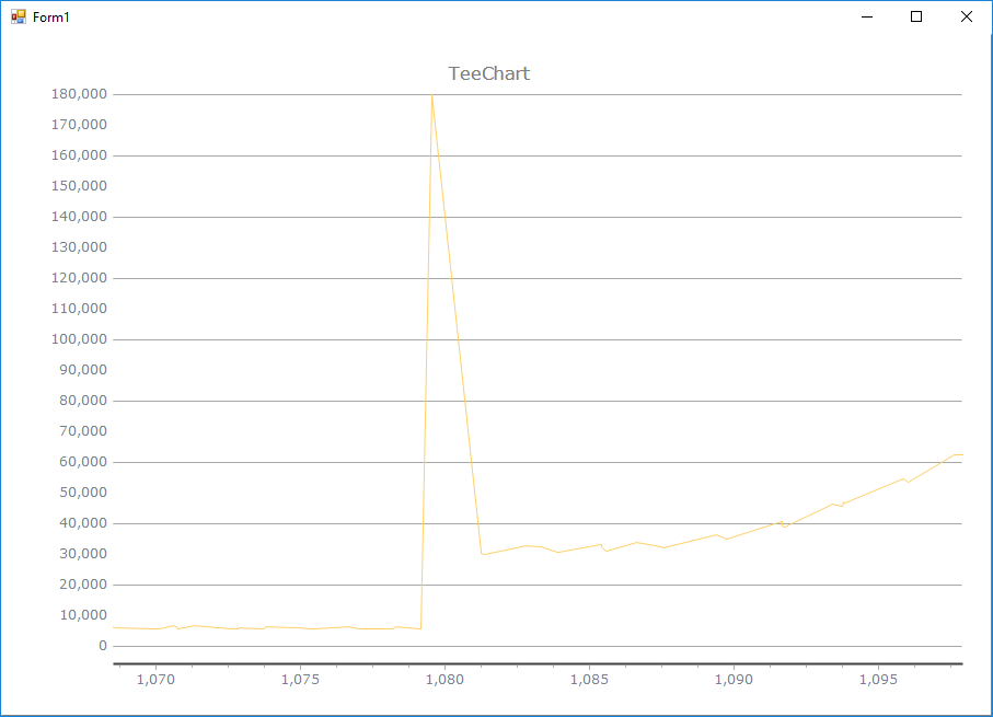

Here is the plot after zooming into the highlighted region above with downsampling enabled, and "CheckDataSource" called in the "Zoomed" event:

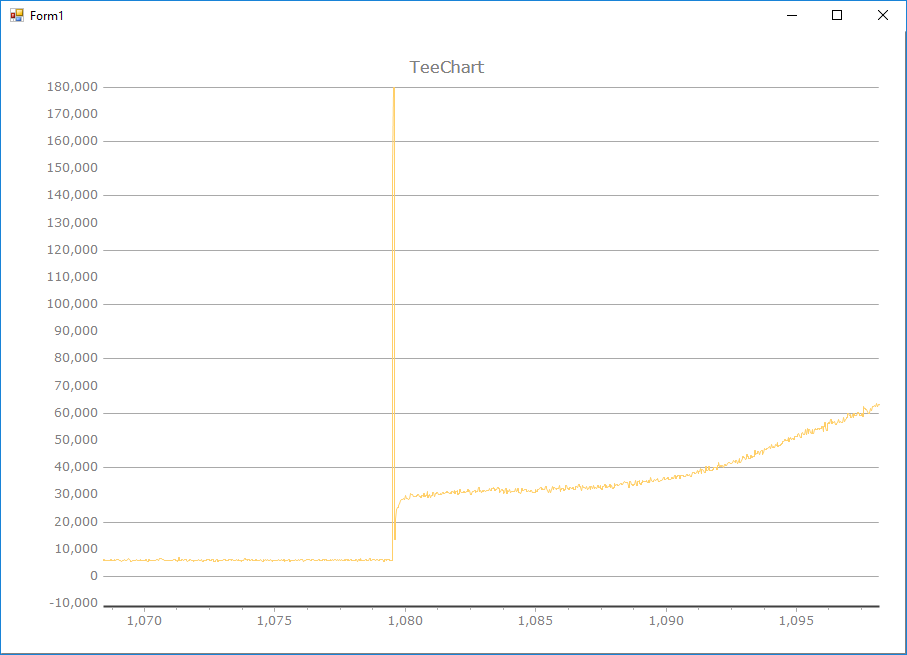

For comparison, here is the same region zoomed in to the original source data without downsampling:
If you compare the original vs downsampled plot of the zoomed region, you can see that a great deal of detail has been lost in the downsampled plot. It appears to me that CheckDataSource is not re-calculating the downsampled plot to match the displayed region, it is simply displaying a zoomed version of the original 5000-point downsampling of the full data set.
