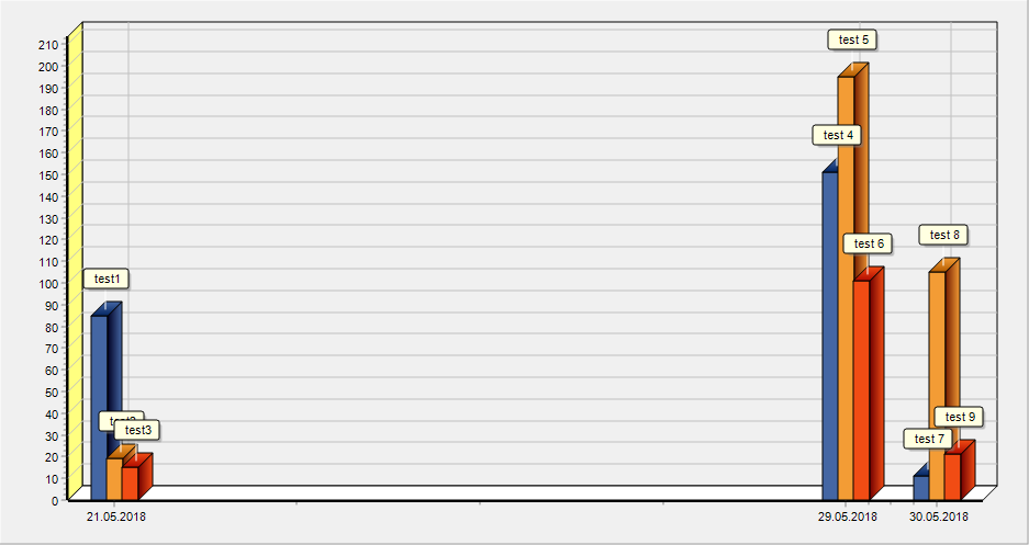

Greetings,
we have an issue with SeriesGroups option. X bar (Axis.Bottom) date time labels are located quite randomly.
How could we adjust your code so that group dates would appear correctly (centred) under group bars?
var
bar: TBarSeries;
  chart1.ClearChart;
  chart1.Legend.Hide;
  (chart1.SeriesGroups.Add as TSeriesGroup).Name:='A';
  (chart1.SeriesGroups.Add as TSeriesGroup).Name:='B';
  (chart1.SeriesGroups.Add as TSeriesGroup).Name:='C';
 //   chart1.BottomAxis.Automatic := false;
//    chart1.BottomAxis.SetMinMax(strtodate('21.05.2018')-3,strtodate('30.05.2018')+3);
    chart1.Axes.Bottom.LabelStyle :=  talPointValue;
//    chart1.Axes.Bottom.LabelsSeparation := 0;
    chart1.BottomAxis.DateTimeFormat := 'dd.mm.yyyy';
    bar := chart1.AddSeries(TBarSeries) as TBarSeries;
    bar.XValues.DateTime := true;
    bar.AddXY(strtodate('21.05.2018'), 85, 'test1');
    chart1.SeriesGroups.Items[0].Add(bar);
    bar.AddXY(strtodate('21.05.2018'), 19, 'test2');
    bar.AddXY(strtodate('21.05.2018'), 15, 'test3');
    bar.AddXY(strtodate('29.05.2018'), 151, 'test 4');
    chart1.SeriesGroups.Items[1].Add(bar);
    bar.AddXY(strtodate('29.05.2018'), 195, 'test 5');
    bar.AddXY(strtodate('29.05.2018'), 101, 'test 6');
    bar.AddXY(strtodate('30.05.2018'), 11, 'test 7');
    chart1.SeriesGroups.Items[2].Add(bar);
    bar.AddXY(strtodate('30.05.2018'), 105, 'test 8');
    bar.AddXY(strtodate('30.05.2018'), 21, 'test 9');

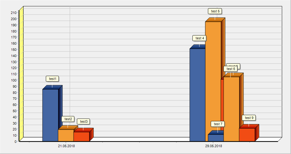

Post by Yeray » Thu Sep 27, 2018 7:48 am
Having 9 TBarSeries, the axis label is placed giving space for all the 9 bars. I've edited your screenshot, moving the bars from the right to the left so they are all together, and you can see how the label is placed correctly:
I would create as many series as bars you want to be placed at the same date. In this case I would create 3 bar series. Ie:

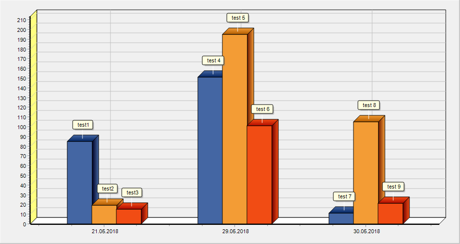

Now the problem is the distance between the days 21 and 29 is very different to the distance between the days 29 and 30. The result is correct but the bars overlap.
I see two options to solve this:
- You could make the 3 bar series thinner:
bar.BarWidthPercent:=20;
- You could fake the xvalues and use the dates for the labels:
    bar.Add(85, 'test1');
    bar.Add(151, 'test 4');
    bar.Add(11, 'test 7');
    bar.Add(19, 'test2');
    bar.Add(195, 'test 5');
    bar.Add(105, 'test 8');
    bar.Add(15, 'test3');
    bar.Add(101, 'test 6');
    bar.Add(21, 'test 9');
    with Chart1.Axes.Bottom.Items do
      Clear;
      Add(0, '21.05.2018');
      Add(1, '29.05.2018');
      Add(2, '30.05.2018');
