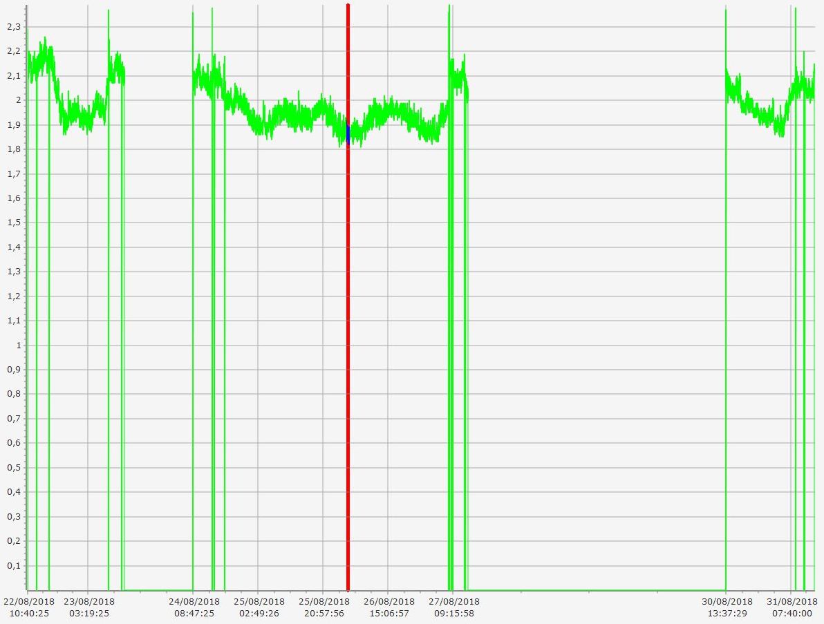

I am using TeeChart Pro with Delphi Tokyo. I want to draw a fastLine serie with empty values.

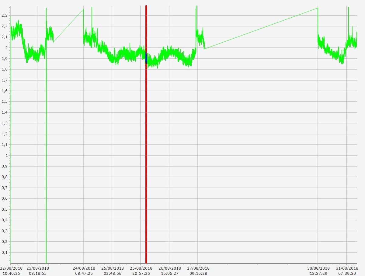

I tried to add empty values with the AddNullXY method but I have vertical lines to 0:
I tried to add empty values with the AddXY(0,0) method but I have diagonal lines connecting last and first visible values:

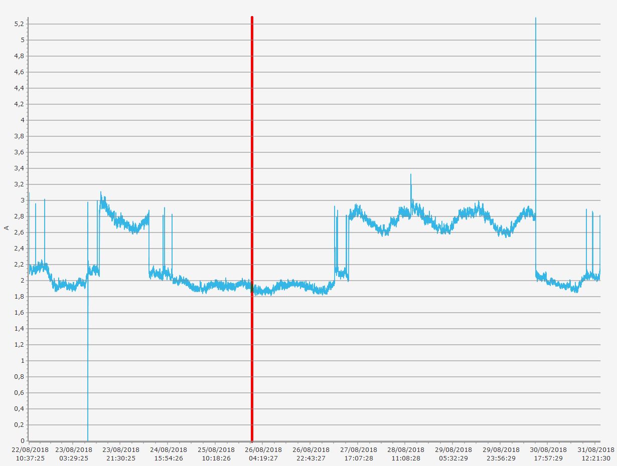

I thought I found a way to have what I want using multiple series: I create an new serie when previous values is empty:
The rendering is OK but I have a TCurorTool object (red vertical line) that shows serie values. When using muItiple series, I can't use TCurorTool OnChange event :x

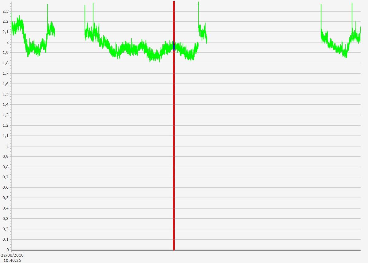

My issue is: how can I get last display with one serie or how can I get serie values with TCurorTool ?

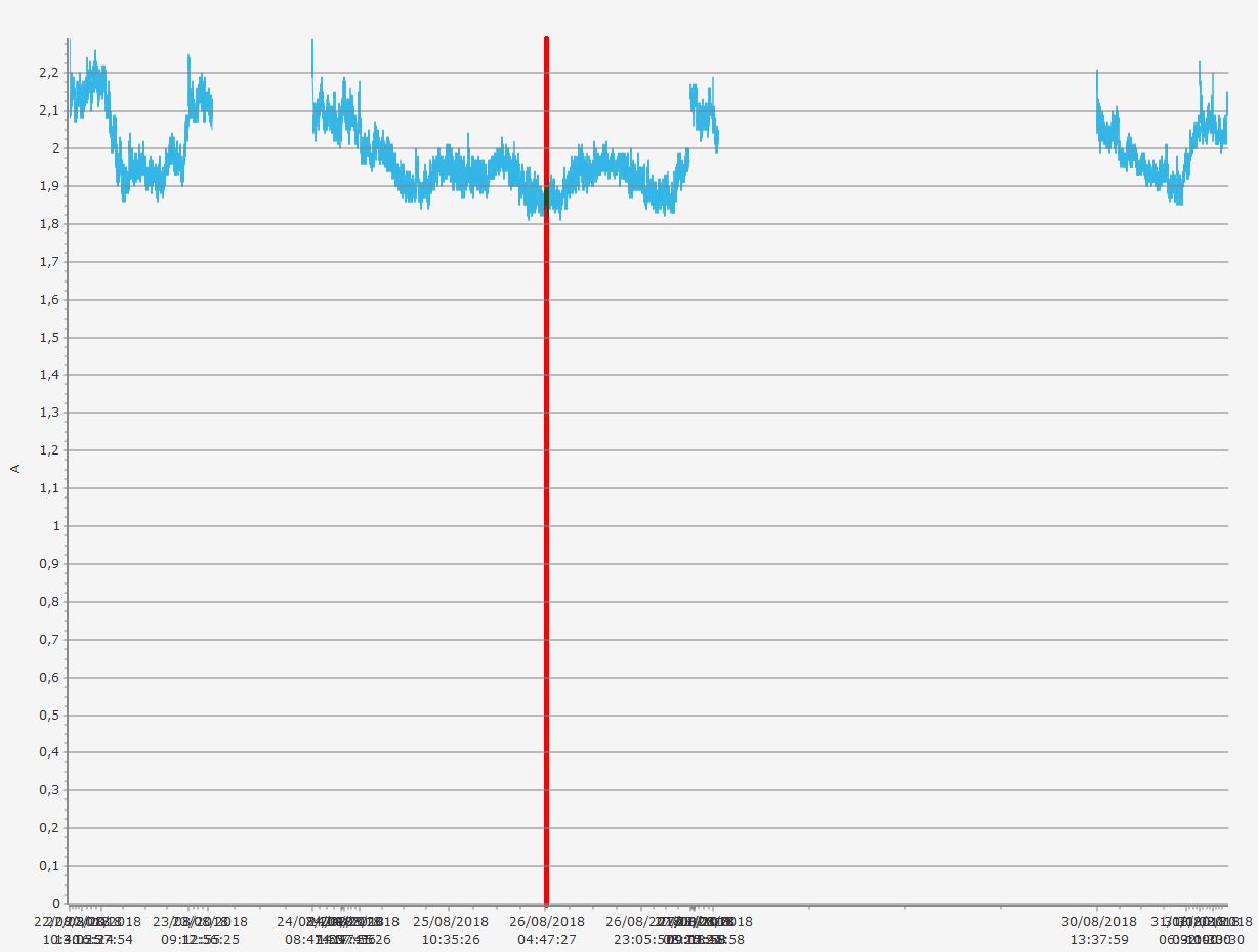

I tried your solution, it barely works. I still have an issue when displaying datas (dates) in abscissis.
In the picture above, I have one serie and I display dates in abscissis --> everything is OK
In the picture above, I use your solution, I have many series and I display dates in abscissis --> labels overlap
I dont' find a way to have a correct display. Do you have an idea ?

If you are converting the dates to strings and passing it to the series as labels when adding the points... ie:
  label:=FormatDateTime('dd/mm/yyyy hh:nn:ss', date);
  series.AddXY(xValue, yValue, label);
In that case I'd suggest you to use the date a xValue. Ie:
  series.AddXY(date, yValue);
You could also try changing the bottom axis labelStyle to talValue:
  Chart1.Axes.Bottom.LabelsStyle:=talValue;
Dynae

Thanks you for the tip but I already tried this and I had some weird values :? I think my date value is converted to double value.

The axis treats the values as DateTimes when it has a ValueList assigned to it with DateTime property set to True. Ie:
  Chart1[0].XValues.DateTime:=true;

It works so fine. Teechart is a powerfull tool !!!
