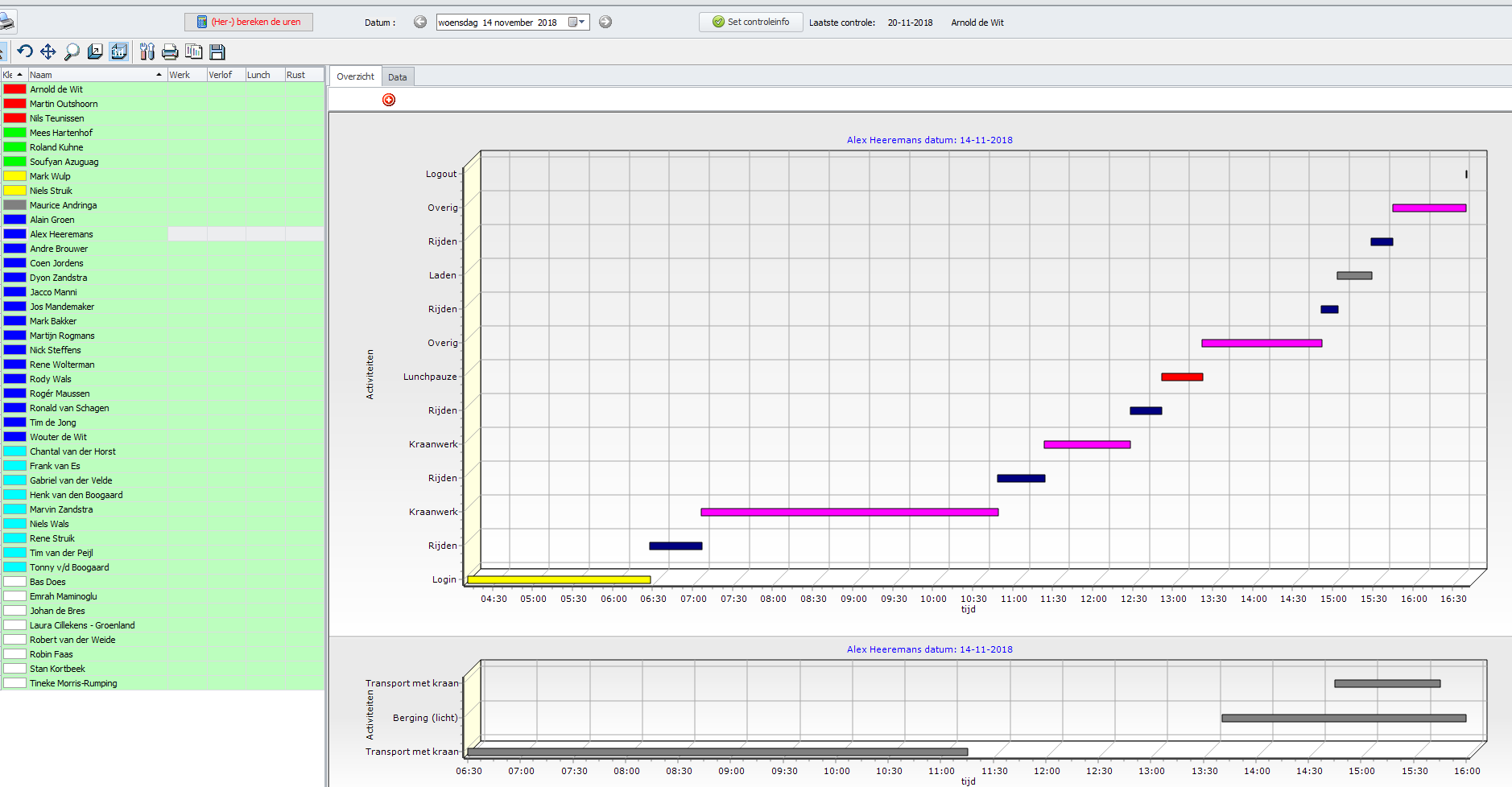

The two Gantt Charts are related. The Timelines are different, however. How can I achieve that they are equal?
Edit the lower Gantt so that it is equal to the upper one?

You can change the bottom axis scale for the lower chart. Ie:
  lowerChart.Axes.Bottom.SetMinMax(upperChart.Axes.Bottom.Minimum, upperChart.Axes.Bottom.Maximum);

Something strange happens: setting the bottom axis happens with a delay of a click. See Video
The Bottomaxis automatic is set to false.
The code is:

Problem solved by putting a Chart1.Repaint
