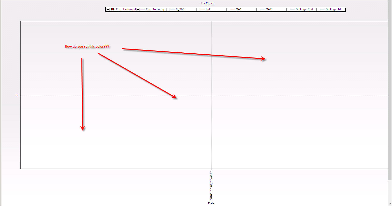

I've looked through every setting in the properties dialog for TChart and can't set the "drawing area" color for the chart for the life of me (see attachment)
. any help would be greatly appreciated.Thanks very much.

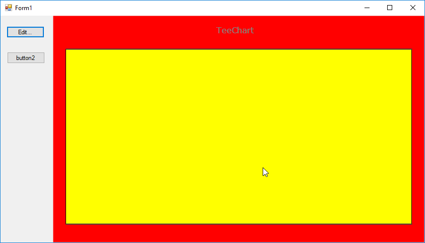

the following code:
			tChart1.Panel.Color = Color.Red;
			tChart1.Walls.Back.Visible = true;
			tChart1.Walls.Back.Transparent = false;
			tChart1.Walls.Back.Color = Color.Yellow;
will give you this chart:
I hope that answers your question!

I spent hours on this! Thanks very much!!!
