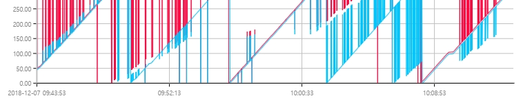

How to change a bottom grid line interval from to one minute ?
I tried to do it, but not works. :?
Always thank you.

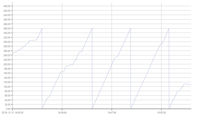

before.
I would like to add more delicate vertical line than before.

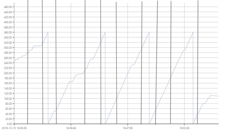

after.( I wish)

You can draw extra grid lines following this example:
var Chart1;
function draw() {
  Chart1=new Tee.Chart("canvas");
  Chart1.addSeries(new Tee.Line().addRandom());
  Chart1.series.items[0].beforeDraw = function() {
  	var c = Chart1.ctx;
  	var a = Chart1.axes.bottom;
  	var v = a.roundMin();
  	var y1 = a.bounds.y;
  	var y2 = Chart1.chartRect.y;
  	c.beginPath();
  	while (v <= a.maximum) {
  		var step = (a.increm / 3);
		var i = v + step;
		while (i < v + a.increm) {
			if ((i > a.minimum) && (i < a.maximum)) {
				var p = a.calc(i);
				c.moveTo(p, y1);
				c.lineTo(p, y2);
			i += step;
  		v += a.increm;
	  a.grid.format.stroke.prepare();
	  a.grid.format.shadow.prepare(c);
	  c.stroke();
  Chart1.draw();
