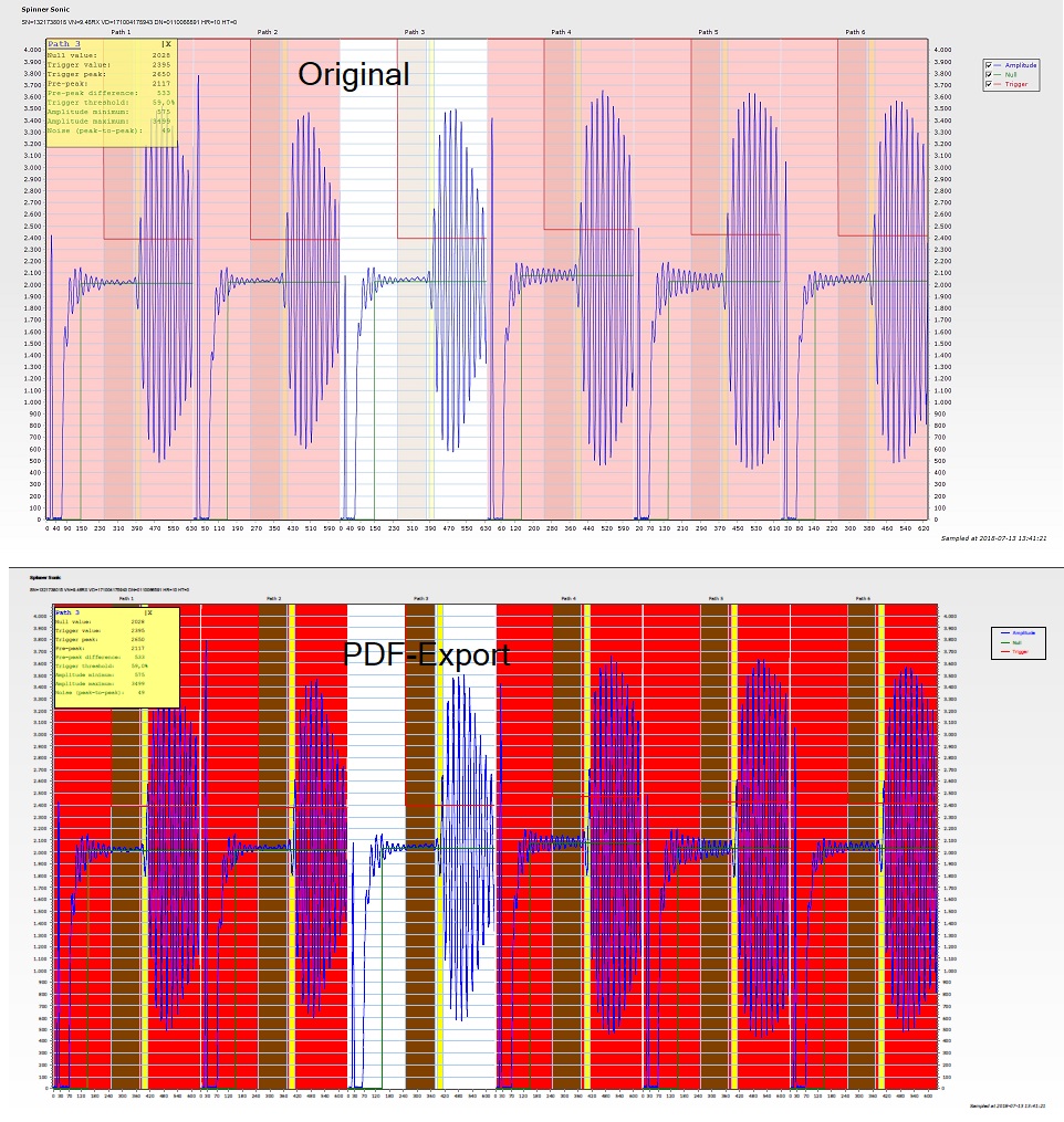

to export a chart to PDF I'm using
TeeSaveToPDFFile(Chart1,'Chart1.pdf');
Unfortunately the colors in the pdf file look completely other than on the original chart.
(See attached picture).
printing the chart on a PDF printer works well.
Can anybody explain what to do to get the right colors using TeeSaveToPDFFile?

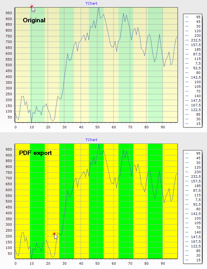

I found the reason of this misbehaviour:
The transparency of the color bands have been set to 80% by program code, but this setting is ignored by the export function TeeSaveToPDFFile.

The results are shown in the attached pictures.
Is there a solution to solve the problem?

We can reproduce the problem. Tha transparency is not interpreted for the pdf export. We'll check for a solution.
