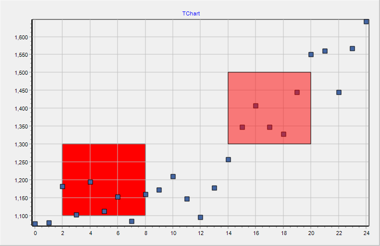

Ie:
uses TeCanvas;
var rect: TRect;
    blend: TTeeBlend;
  with Chart1.Canvas do
    rect.Left:=Chart1.Axes.Bottom.CalcPosValue(14);
    rect.Right:=Chart1.Axes.Bottom.CalcPosValue(20);
    rect.Top:=Chart1.Axes.Left.CalcPosValue(1300);
    rect.Bottom:=Chart1.Axes.Left.CalcPosValue(1500);
    Brush.Color:=clRed;
    ClipRectangle(Chart1.ChartRect);
    blend:=BeginBlending(rect, 50);
    Rectangle(rect);
    EndBlending(blend);
    UnClipRectangle;
procedure TForm1.Chart1BeforeDrawAxes(Sender: TObject);
var rect: TRect;
    rect.Left:=Chart1.Axes.Bottom.CalcPosValue(2);
    rect.Right:=Chart1.Axes.Bottom.CalcPosValue(8);
    rect.Top:=Chart1.Axes.Left.CalcPosValue(1100);
    rect.Bottom:=Chart1.Axes.Left.CalcPosValue(1300);
    Brush.Color:=clRed;
    Rectangle(rect);
    UnClipRectangle;

As regards blending, the shape I'm drawing is a polygon, not a rectangle, and blending seems to require the specification of a rectangle. So I tried blending with the entire chart rectangle and that works okay too. If I plot the polygon in the OnBeforeDrawAxes event, then I get the result I want, which is that the series points sit above the blended polygon, and aren't blended themselves. Fantastic too!
