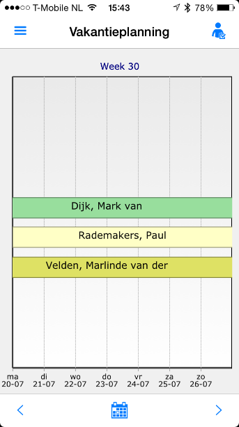

Currently we are having an issue with a Gantt chart in our Xamarin.Android and Xamarin.iOS application.
We recently upgraded our TeeChart dlls from version 4.15.07.01 to 4.2018.10.3 to fix a crash occurring on newer Android and iOS versions. This is a 3 year version leap, so with it came the expected visual changes and issues.
In the 2015 version our gantt chart it looked like this:

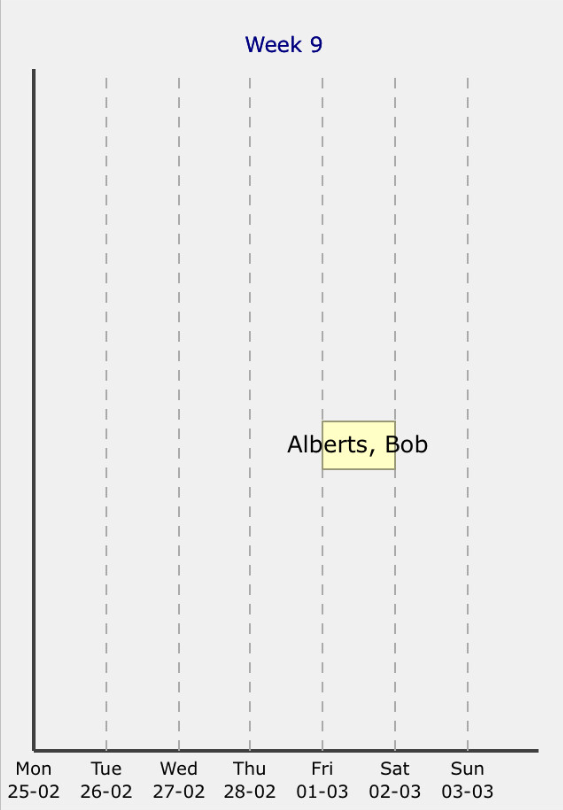

Using the 2018 TeeChart build it looks like this:
While the marks, bottom axis looks mostly the same and works fine, the borders and grid lines are missing.
I managed to restore the grid lines using:
tChart.Axes.Bottom.Grid.DrawEvery = 1;
tChart.Axes.Bottom.Grid.Visible = true;
However, I cannot seem to restore the black border around the chart. I've tried the Wall properties, the Panel.BorderPen properties etc. but to no avail.
Is there any way to re-create such a border in v2018?
sure, to bring this default look to previous versions you can use a single line:
tChart.CurrentTheme = ThemeType.Opera;
TTApp
Posts: 3
Joined: Thu Feb 21, 2019 12:00 am
Re: Border in Gantt Chart
Post by TTApp » Fri Mar 08, 2019 2:05 pm
Thank you very much for the response. While this did revert the style the right and top borders still seem to be missing.
Changing the wall/border settings on the chart doesn't seem to make them appear or change.
What could be the cause of this?
Pep
Posts: 3316
Post by Pep » Mon Mar 11, 2019 9:11 am
ok, I think that back wall still invisible. Adding the following lines of code should make the change :
			tChart.Walls.Back.Transparent = false;
			tChart.Walls.Back.Pen.Visible = true;
			tChart.Walls.Back.Visible = true;
TTApp
Posts: 3
Post by TTApp » Mon Mar 11, 2019 12:40 pm
Restoring the back wall resolved the issue. Thank you very much for your help!
