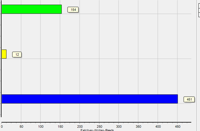

I fill chart w/data programmatically. When I run the same data fill routines again, the horizontal bars are halved in height and/or spaced further apart. If I run again spaced off the chart.
I have tried clearing the chart/series/groups but to no avail. I have to shut the program and restart to get the intended chart back
The form containing the chart is not destroyed on close but hidden.
How does one clear the chart effectively?

Maybe you are clearing the old series without deleting it. Then if you are creating a new series the chart reserves the space for both series, independently of the data they contain.
However, I can only guess. If you still find problems with it, please arrange a simple example project we can run as-is to reproduce the problem here.

I set chart FreeAndNil and recreate each time I want to fill it with new data. Created other problems but that is another issue.
