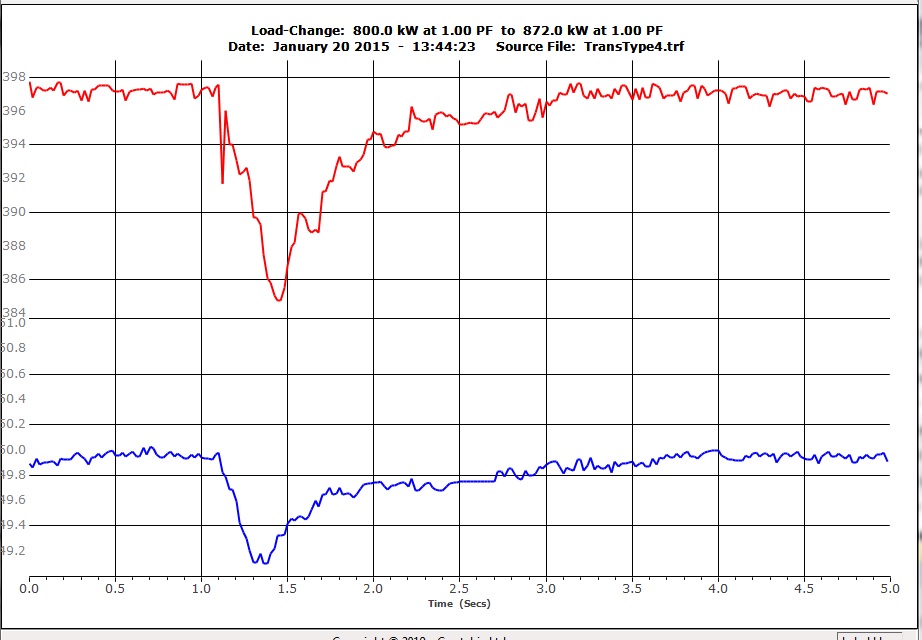

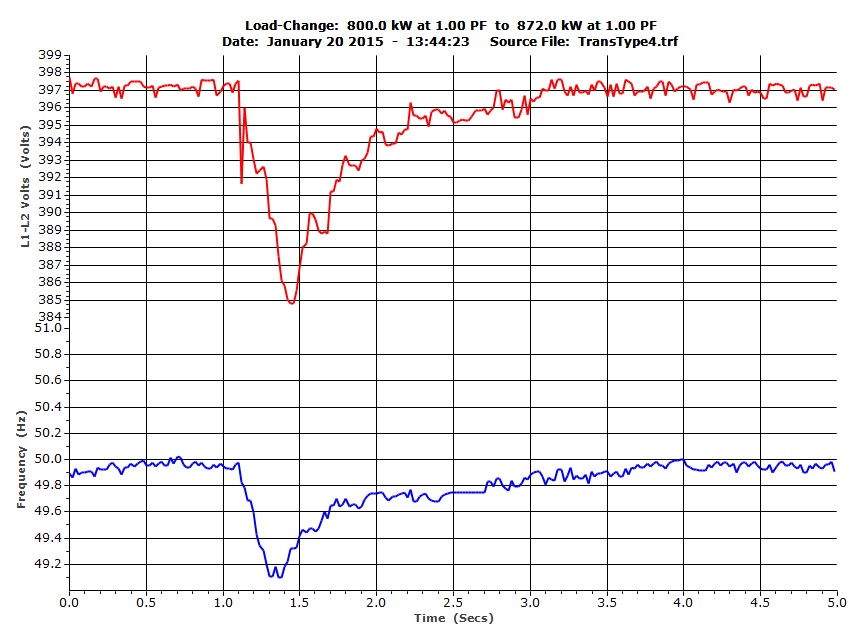

Hi
I am a relative beginner with Tee Chart and am programming in C# and using TeeChart Pro V 4.2019.3.15. for .NET. I am doing most of the chart manipulation programmatically, rather than using the VS designer.
My problem is with custom axes. I initially set-up a basic chart with 1 series using the left and bottom axis and it displayed fine. As I need to use stacked charts I then switched to using creating a couple of custom axis and transferred the initialization I had done for the left axis to these axis. I am 80% of the way there but the chart's stacked axes are not displayed as expected, see below.
As you can see the labels are displayed in the default grey and I cannot get the axis caption to display in any colour! I have been trying since the end of last week at tweaking various attributes but nothing I do seems to effect the label and caption display.
My code loops through each custom axis I have created (I've checked there are only two defined) performing the following:
Axis objAxis = m_objChart.Axes.Custom[nTraceCount];
... set axis start/end position, visibility on, activate a series and associate it with this axes (all of which appear to be working)...
objAxis.Grid.Visible = true;
objAxis.Horizontal = false;
objAxis.Ticks.Color = Color.Black;
objAxis.MinorTicks.Color = Color.Black;
objAxis.Labels.Color = Color.Black;
objAxis.Title.Visible = true;
objAxis.Title.Color = Color.Black;
objAxis.Title.Caption = "Test Title";
So my questions are:
1) Is there something I need to do, beyond the setup required for a Left Axis, to allow the custom axis label defaults to be changed?
2) Why are neither of the custom axis title captions displayed?
3) Why is the chart clipping on the left-hand side - I have set the chart margins to 3% on all sides and the top, bottom and right margins appear to be correct.
4) Why are the custom axis lines not drawing?
5) The first and last grid lines for the Bottom Axis (Time) appear to have been omitted. I did not notice this when using a single series left/bottom axis chart. Is this because I am now using custom axis, and how do I get them back?
6) Is there an example of the programmatic setup of a stacked chart using custom axes you could link me to?
Any guidance you can give me will be greatly appreciated.
Many thanks in advance
Rob

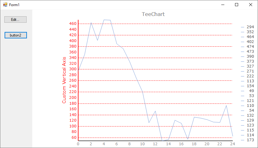

Re: Custom Axis Label and Title display issues
Post by Christopher » Tue Apr 23, 2019 7:00 am
Hello Rob,
firstly, many apologies for the lateness of this reply.
Please find following an example of how to add and modify a custom axis - in this example the changes are performed in the button click event:
			InitializeChart();
        Line _line = new Line();
            tChart1.Series.Add(_line);
            _line.FillSampleValues();
            var axis = new Axis(tChart1.Chart);
            axis.AxisPen.Visible = true;
            axis.AxisPen.Color = Color.Red;
            axis.Grid.Visible = true;
            axis.Grid.Style = System.Drawing.Drawing2D.DashStyle.DashDotDot;
            axis.Grid.Color = Color.Red;
            axis.Labels.Font.Color = Color.Red;
            axis.Title.Font.Color = Color.Red;
            axis.Title.Text = "Custom Vertical Axis";
            axis.Title.Angle = 90;
            tChart1.Panel.MarginUnits = PanelMarginUnits.Pixels;
            tChart1.Panel.MarginLeft = 150;
            tChart1.Axes.Custom.Add(axis);
            _line.CustomVertAxis = axis;

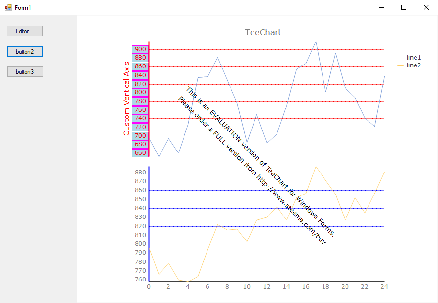

Post by Christopher » Mon Apr 29, 2019 5:57 pm
Hello Rob,
some code:
            InitializeChart();
        Line _line = new Line(), _line1 = new Line();
            tChart1.Series.Add(_line1);
            _line1.FillSampleValues();
            axis.Labels.Transparent = false;
            axis.Labels.Pen.Color = Color.Fuchsia;
            axis.Labels.Color = Color.LightBlue;
            var axis1 = new Axis(tChart1.Chart);
            axis1.AxisPen.Visible = true;
            axis1.AxisPen.Color = Color.Blue;
            axis1.Grid.Visible = true;
            axis1.Grid.Style = System.Drawing.Drawing2D.DashStyle.DashDotDot;
            axis1.Grid.Color = Color.Blue;
            axis.StartEndPositionUnits = PositionUnits.Percent;
            axis.StartPosition = 0;
            axis.EndPosition = 48;
            axis1.StartEndPositionUnits = PositionUnits.Percent;
            axis1.StartPosition = 52;
            axis1.EndPosition = 100;
            tChart1.Panel.MarginUnits = PanelMarginUnits.Percent;
            tChart1.Panel.MarginLeft = 20;
            tChart1.Axes.Custom.Add(axis1);
            _line1.CustomVertAxis = axis1;
and the result:
1) when the Labels shape is set to opaque (Transparent=false) the effect of the Label Pen and Color can be seen
2) the left margin works as expected with MarginUnits set to Percent
3 & 4) all grid lines and labels are rendering as expected

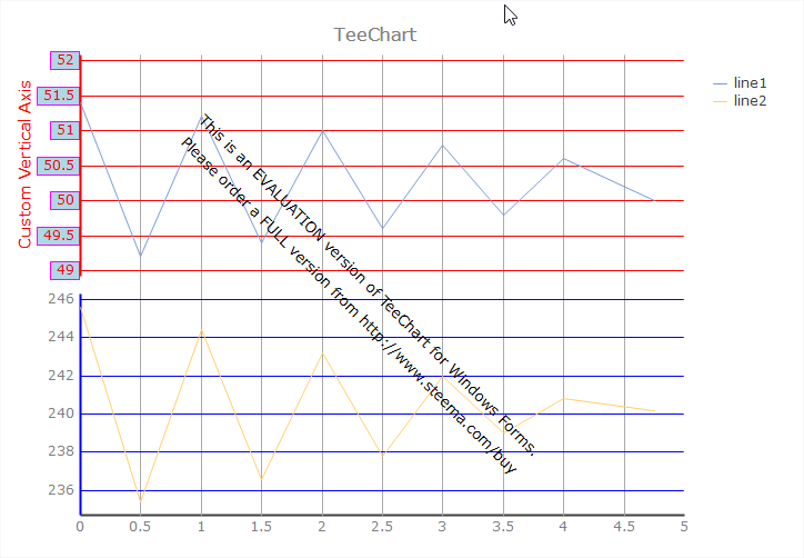

Post by Rob W » Tue May 14, 2019 1:25 pm
Hi Christopher,
Firstly, thanks for your illustration about the effects of the different label color methods and the code behind it. I now understand what each does and have solved that problem.
I am still struggling to achieve the effect that I am after where grid lines are drawn at the start and finish of each axis. To illustrate the problem I have taken your sample code from my last question and adapted it to try and produce the grid lines.
The modifications are:
Replace the random generation of a series with explicit values for repeatability and so any math needed to calculate the axis limits is not needed.
Call functions to set the axes limits to "integer" values, set the grid line increment so grid lines are displayed at least at these "integer" values (if not more frequently) and set the grid to be drawn at every label.
The code used is this..
	public partial class TestChartPanel : UserControl
		public TestChartPanel()
			InitializeChart();
		private void TestChartPanel_Load(object sender, EventArgs e)
			var axis1 = new Axis();// tChart1.Chart);
			// call functions to some additions to axes to (hopefully) get the
			// grid to encompas all the series data points and draw grid line
			// at first and last labels on each axis
			tChart1.Axes.Bottom.Grid.Visible = true;
			TimeAxisAdditions();
			FreqAxisAdditions();
			VoltAxisAdditions();
		float[] fTimeVals =
			0.0F, 0.5F, 1.0F, 1.5F, 2.0F,
			2.5F, 3.0F, 3.5F, 4.0F, 4.75F
		float[] fFreqVals =
			51.4F, 49.2F, 51.2F, 49.4F, 51.0F,
			49.6F, 50.8F, 49.8F, 50.6F, 50.0F
		float[] fVoltsVals =
			245.6F, 235.4F, 244.4F, 236.6F, 243.2F,
			237.8F, 242.0F, 239.0F, 240.8F, 240.2F
			for (Int32 i = 0; i < 10; i++)
				_line.Add(fTimeVals[i], fFreqVals[i]);
				_line1.Add(fTimeVals[i], fVoltsVals[i]);
		private void TimeAxisAdditions()
			Axis objAxis = tChart1.Axes.Bottom;
			// try to get the grid to encompass all the series data points by
			// extending the maximum limits of the axis to next label
			objAxis.Automatic = false;
			objAxis.Increment = 0.5F;
			objAxis.Minimum = 0.0F;
			objAxis.Maximum = 5.0F;
			objAxis.MinimumRound = true;
			objAxis.MaximumRound = true;
			// get solid grid lines to draw at every label
			objAxis.Grid.Style = System.Drawing.Drawing2D.DashStyle.Solid;
			objAxis.Grid.DrawEvery = 1;
			return;
		private void FreqAxisAdditions()
			Axis objAxis = tChart1.Axes.Custom[0];
			objAxis.Increment = 0.25F;
			objAxis.Minimum = 49.0F;
			objAxis.Maximum = 52.0F;
			return;
		private void VoltAxisAdditions()
			Axis objAxis = tChart1.Axes.Custom[1];
			objAxis.Increment = 1.0F;
			objAxis.Minimum = 235.0F;
			objAxis.Maximum = 246.0F;
			return;
This results in the chart shown below:
I was hoping to see horizontal grid lines at the 52 and 49 label position on the upper chart Y-axis, the 246 and 235 position on the lower chart Y-axis, and vertical grid lines at the 0 and 5 position on the bottom axis.
I guess my question is there any way to get grid lines to be drawn at the start and finish of each axis, and if not, is there any other way of accomplishing the effect I am after?
Again, many thanks for your help and patience!
Best Regards
Rob

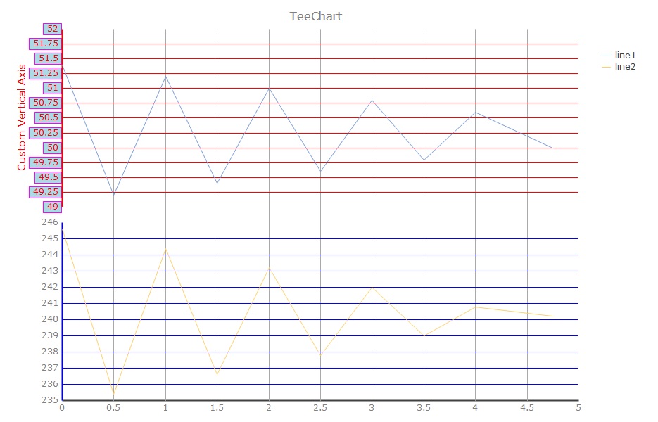

Post by Christopher » Fri May 17, 2019 6:54 am
Well, you could try adding the following two lines to FreqAxisAdditions() and VoltAxisAdditions():
            objAxis.MinimumOffset = 5;
            objAxis.MaximumOffset = 5;
