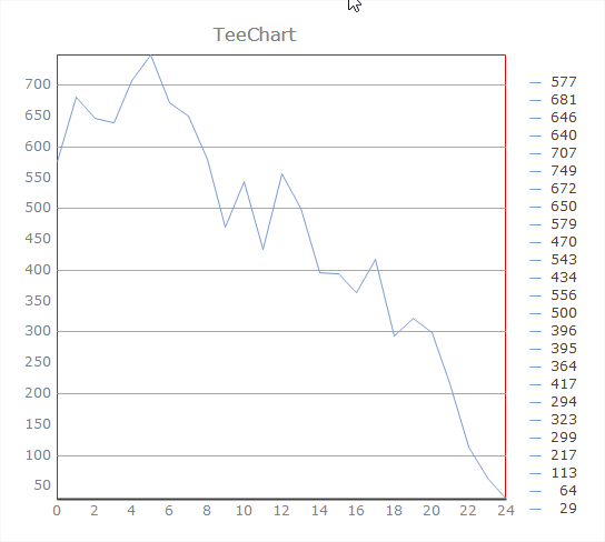

After version updating TeeChart 4.1.2012.1032 ==> 4.2018.11.27
The top outer border does not appear.
Can you guess what the problem is?

Do you have the Back Wall set to visible? Using the following code works as expected here:
            InitializeChart();
            tChart1.Walls.Back.Visible = true;
            tChart1.Walls.Back.Pen.Color = Color.Red;

Hello.
I tried following the attached code above , but it doesn't work. :|
There is no change..
Do you have any other ideas?
Re: The top outer border does not appear.
Post by Christopher » Mon May 27, 2019 8:34 am
please find attached a Visual Studio project which correctly replicates the code I gave you in my last post:
WindowsFormsApp1.zip
(218.03 KiB) Downloaded 1356 times
Can you please modify the code in this project and post it back here so I can reproduce your problem on my machine?
