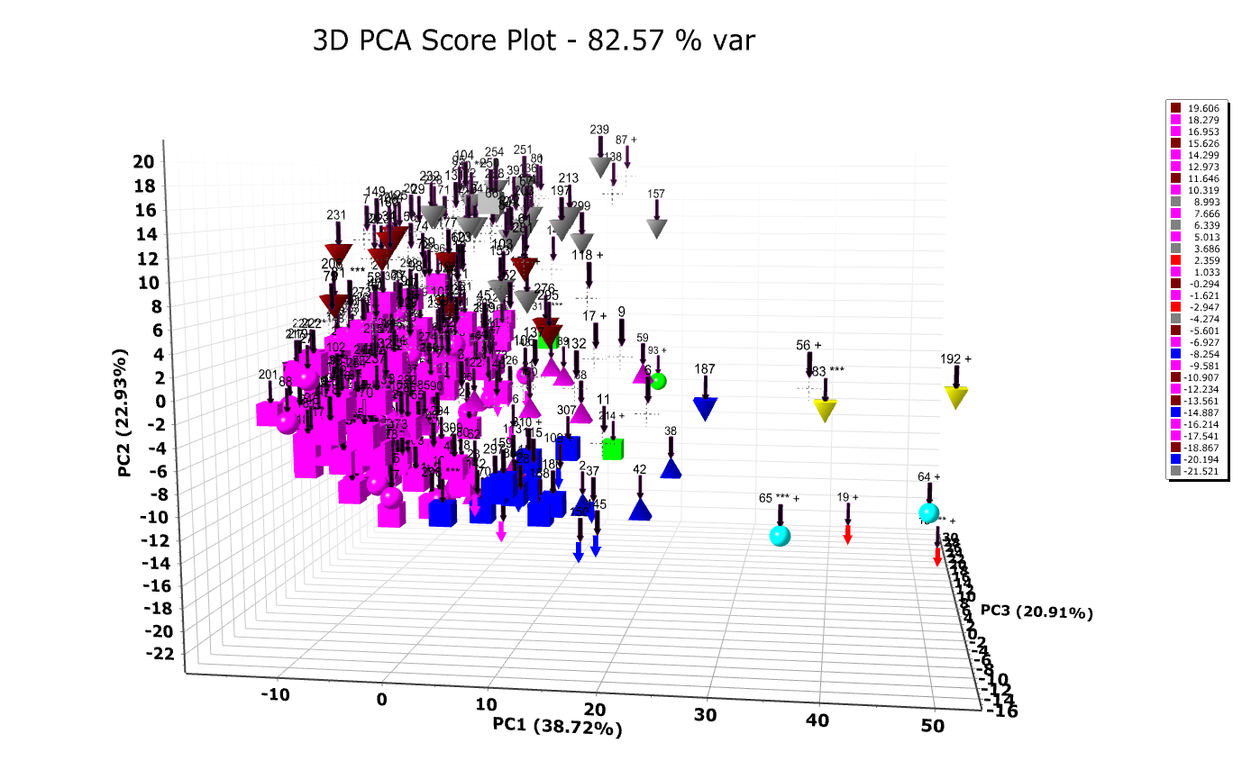

We have a 3D plot where for the points different Pointer styles are used:
What is the best way to draw/add a (custom) legend showing the different used Pointers with some custom text?
The requirement is to display (legend like) what the meaning of the different pointers is.

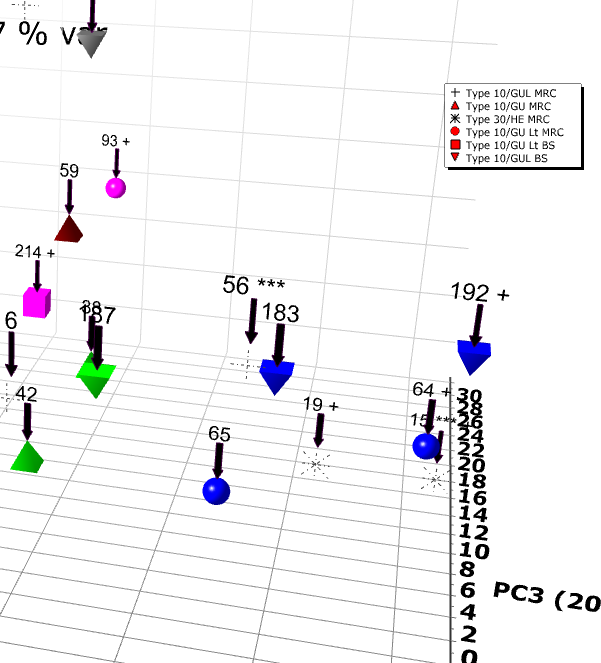

Post by axrDegen » Mon Jul 01, 2019 2:49 pm
indeed that works nicely:
It's just that the pointers in the legend a painted 2D and in the graphics these are
painted 3D. Is there a way to get 3D pointers in legend too ?
Thanks and best regards,

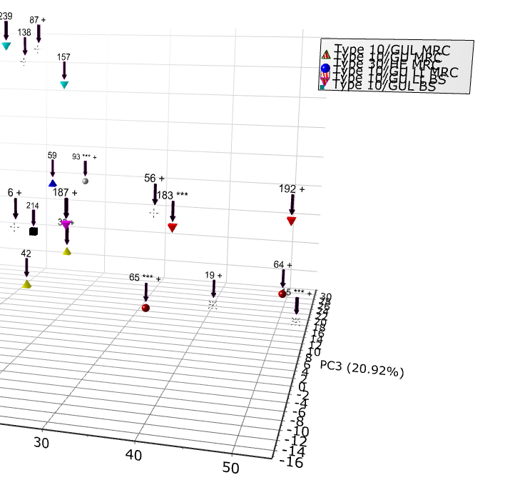

Post by axrDegen » Wed Jul 03, 2019 8:03 am
thank you for the code, in principle that works.
But looking at the plot this still needs serious tweaking:
Distance and sizes are not Ok and also some pointers are missing.
I may for the next release rather stay with the 2D legend.
best regards
