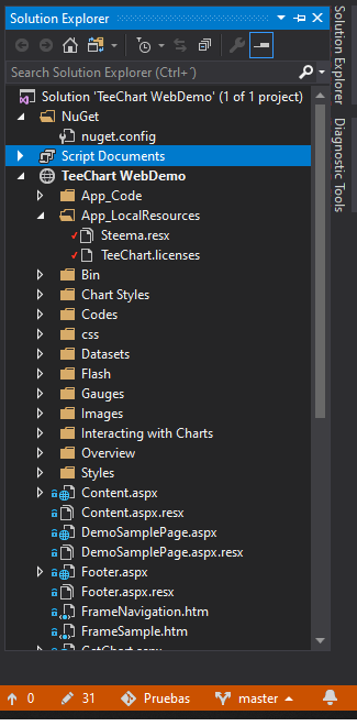

yes, this should be better documented, we're sorry. To see the TeeChart.licenses file working for a web site, you can clone the WebDemo GitHub repo from here - when you open the solution in visual studio you should see the following:
if you replace the contents of the fake TeeChart.licenses with the contents of a real TeeChart.licenses and rebuild you should see the watermark disappear. This is the required structure - a resx file named Steema.resx with the TeeChart.licenses file embedded in it.

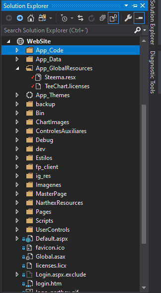

I did what you've recommended:
The TeeChart.Licenses is the one generated by TeeCalc_Lic, and Steema.resx the one in GitHub
but still get the watermark.
I'm using VisualStudio 2019 Professional and the Target Framework for the web site is .NET Framework 4.7.2.

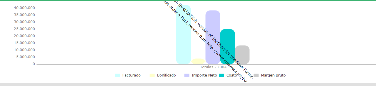

The WebApplication it is ok,
but the website keep on showing the watermark.
Any other clue?

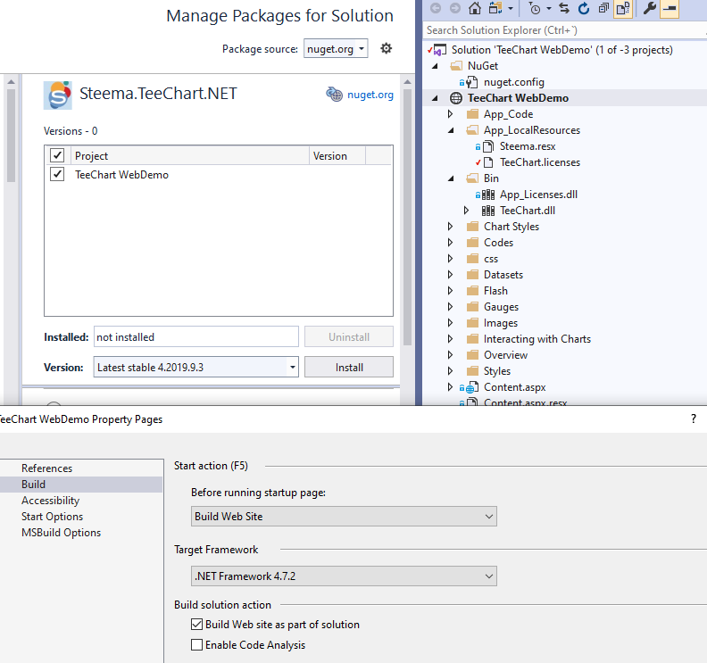

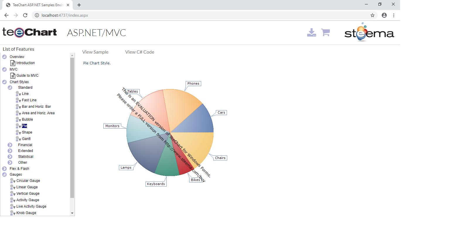

I've done exactly what you ask, except that changed the target .NET Framework to 4.7.2 and it doesn't work as expected:
Here the project explorer:
As I've commented before, in projects type WebApplication an Windows forms, I solved the watermark problem with the same TeeChart.Licences.

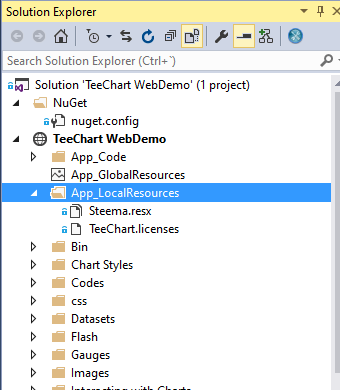

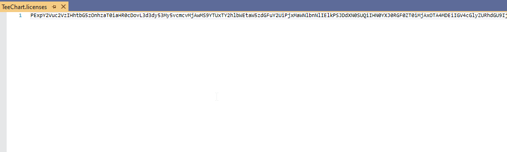

I am using this configuration:
Along with a valid TeeChart.licenses file:
And I obtain the following result:

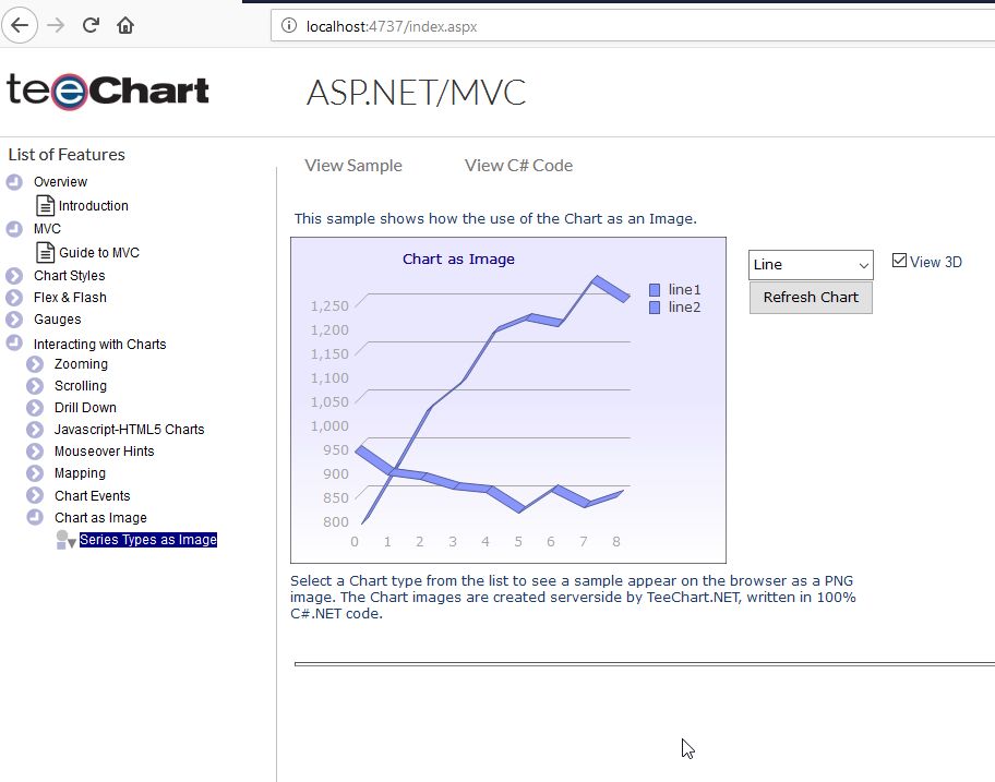

Hi, what I'm experiencing in the demo is:
If I unistall teechart, install it again (via nuget) and runs the app, it works and shows charts without watermark, but only the first time. And when Visual Studio is closed and reopen, the watermark appears again.
More, if I delete TeeChart.licenses from Steema.resx, and add it again, the same result, when the app run, the watermark is not showed, but once closed and reopened Visual Studio, the watermark appears again.

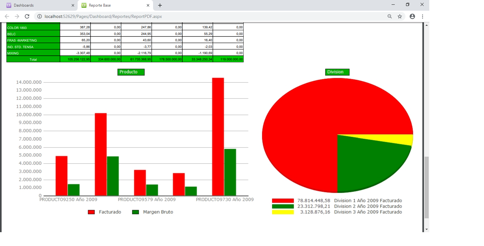

Hi, this version solved the problem in the demo, but in my real project I'm still see watermark. In it, I create dinamically the chart, something keep wrong. Could you test it in a page where the chart is created dinamically in code behind?
regards

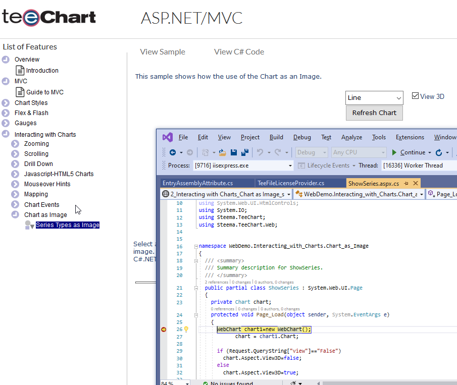

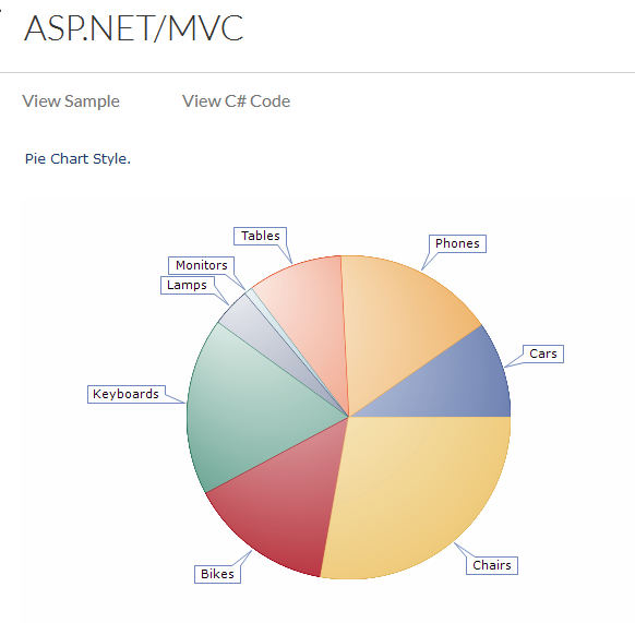

There's a page in the TeeChart WebDemo that creates a chart dynamically at runtime:
This page and chart appears without a watermark using the latest NuGet version:
If you still have problems in this area, could you please create a minimal, reproducible example and upload it to:
http://steema.net/uploads/

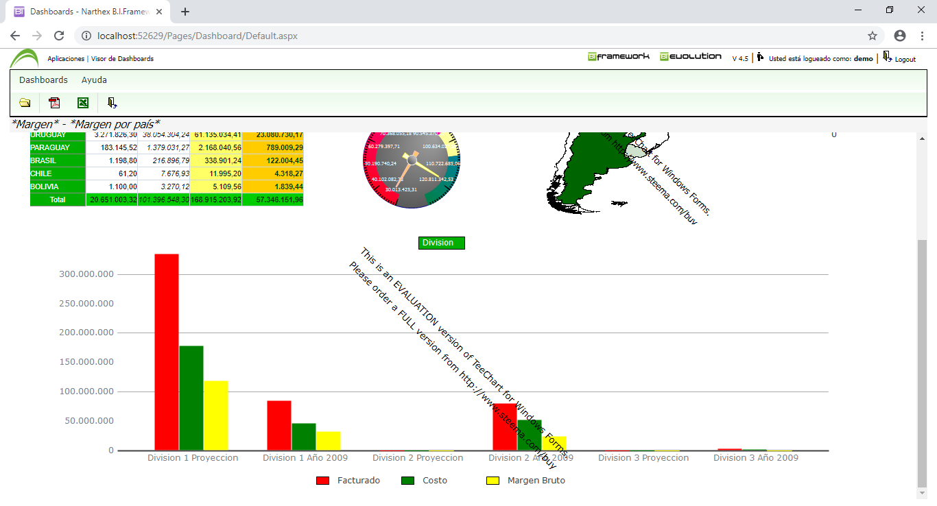

Hi, i will try, but it is no easy.

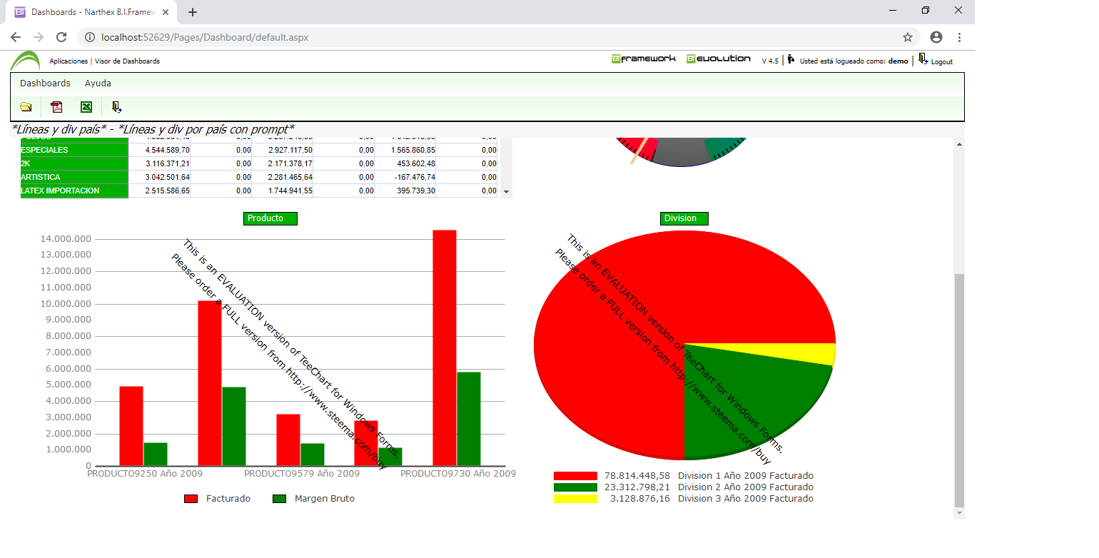

In a windows service the teechart is created and serialized, via WCF comes to WebSite where is deserialized in a new webchart. I've know the windows service got the license because it generates pdfs without watermark.
In the website, no matter the license files are present or not, the chart is shown the same way (with watermark)......
