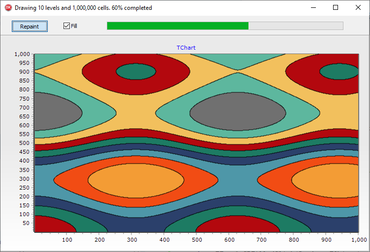

Post by Yeray » Mon Oct 14, 2019 10:05 am
The method that needs more time is the TIsoSurface.DrawCell. We could add an event in it but it could have a negative impact on the performance.
Ie:
I'll send you a test unit and an example of usage.
