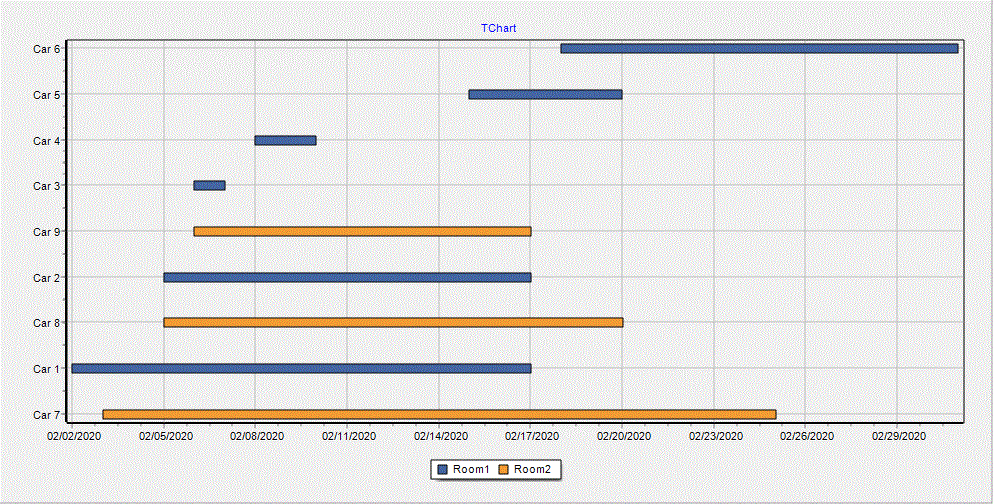

But, I've been thinking about the way to represent the different vehicles at the same rooms, with the possibility to have some on the same dates and found a way that maybe could help :
It would be to repressent the rooms by using different Gantt Series, each one with different color, then you can add each car to specific Series (room) on specific dates (start and end) and set a unique Y Value for each one (entry).
This way all vehicles will be displayed, and not overlapped. Here the example :

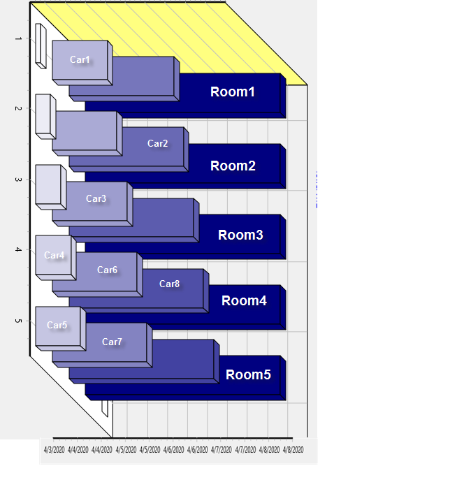

hcamacho
Posts: 7
Joined: Tue Apr 16, 2019 12:00 am
Re: z axis on gantt series
Post by hcamacho » Tue Feb 04, 2020 5:08 pm
Thanks Pep, if you can add the Z axis that has the tower series to the gannt series, it would be great, I add an image of how it could work, the purple bars represent the spaces available in the rooms (I do this with a series of gannt), the other bars represent the cars inside the rooms (this I do with a series of gannt using the Z axis), so you could easily visualize the empty spaces inside the rooms

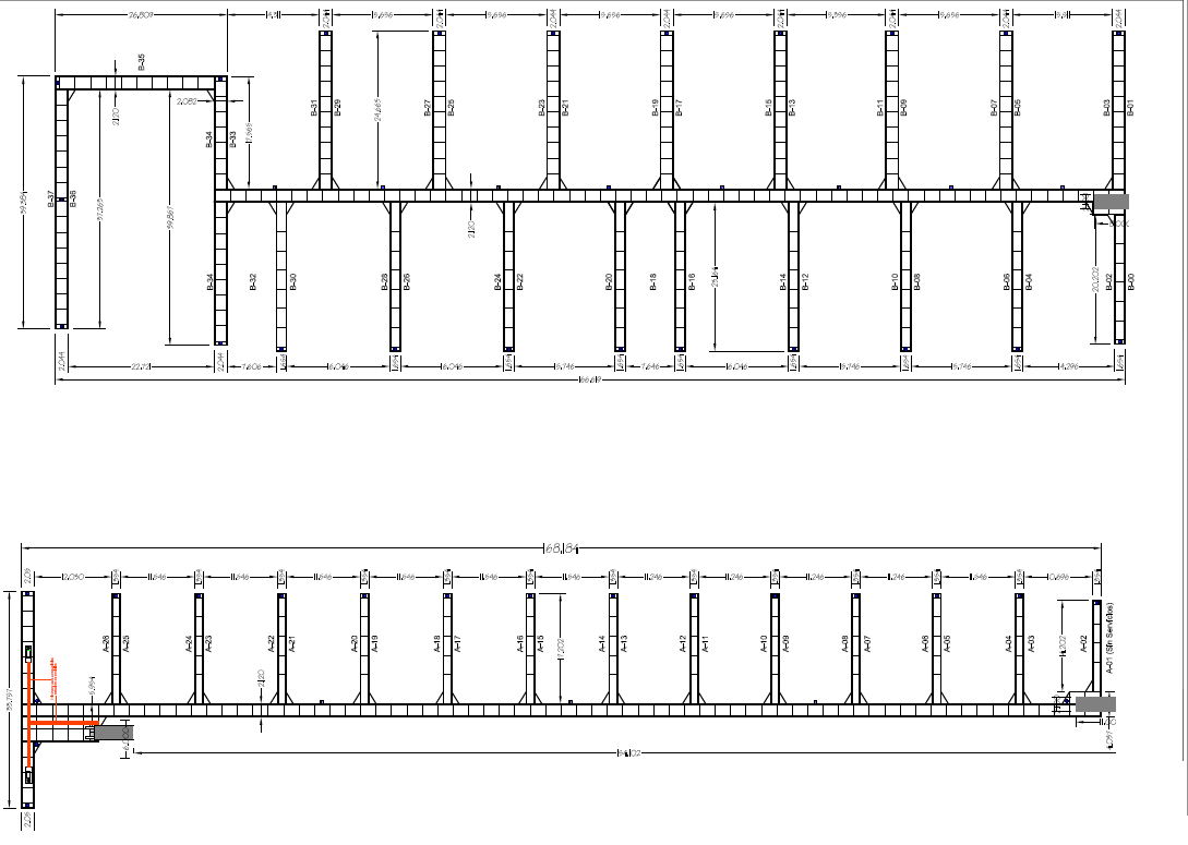

Thanks Pep, I attached a sketch of a part of the parking lot, it is only possible to park a maximum of 4 cars per space, making a graphic per space it would be very difficult to visualize the empty spaces, the measures of the sketch are in feet
Thank you

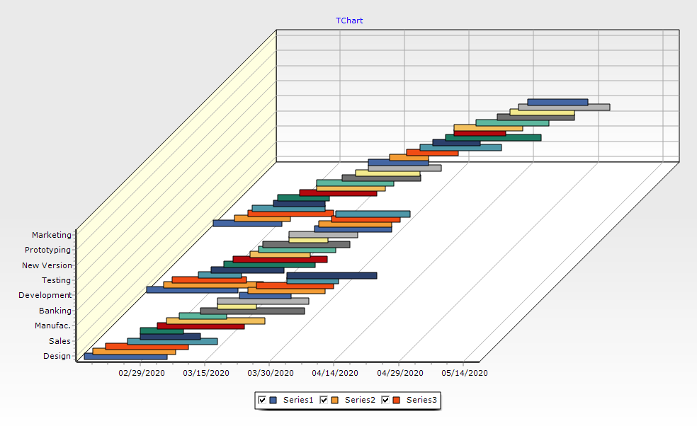

ok, looking for other alternatives I forgot a to mention a way that could be done by using the actual version. It's by using Gantt series with the ZOrder, and also use the Legend checkboxes in order to manage which ones you want to activate or not.
A code example could be :
var i : integer;
  for i := 0 to 2 do
    Chart1[i].FillSampleValues();
    (Chart1[i] as TGanttSeries).Pointer.Draw3D := False;
    (Chart1[i] as TGanttSeries).ConnectingPen.Visible := False;
    (Chart1[i] as TGanttSeries).ZOrder := Chart1[i].SeriesIndex;
  Chart1.Legend.CheckBoxes := True;
  Chart1.Chart3DPercent := 200;
And the result would be :

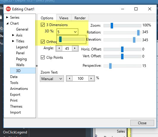

Hi Pep, how do I change this property with code? , this improves the view of the chart
Pep
Posts: 3316
Post by Pep » Mon Feb 17, 2020 10:25 am
It can be done via code using :
