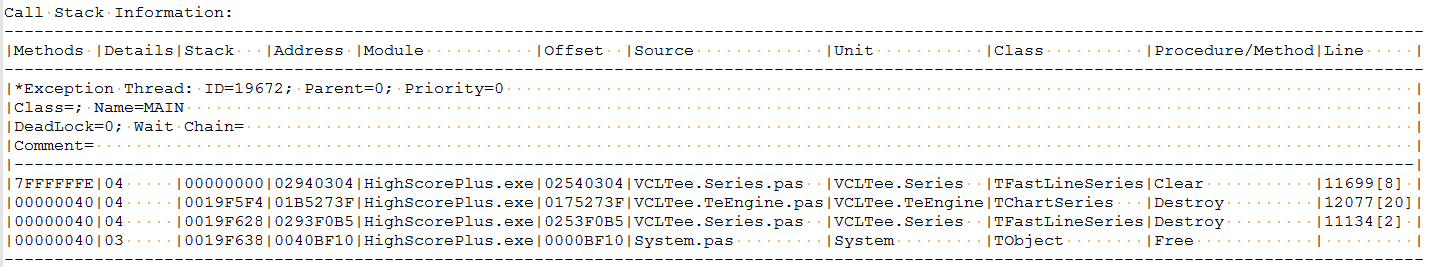

Since version V2019.28 we see often the following crash (not reproducible in a test project yet)
when freeing a window with a TChart:
The multiple TFastLineSeries are created runtime like that:

When we use older TChert sources or when we use TLineSeries instead of TFastLineSeries no such crashes occur.
Any thoughts about what could happen in TFastLineSeries.Clear or what could be wrong with creation of the TFastLineSeries?

I've been trying to reproduce the problem with your code in a simple example without success. The call stack looks like the one you've posted but Clear method ends without errors.
While you can't send us a simple example, if you can tell us in what TeeChart version you weren't reproducing the problem, it may help us to reduce the scope.

I debugged this already, it seems the clear gets still executed when everything is already destroyed.
procedure TFastLineSeries.Clear;
  inherited;
  if (ParentChart <> nil) then
    With ParentChart,Canvas do
        OldX := GetVertAxis.PosAxis; //LeftAxis.PosAxis;
        OldY := GetHorizAxis.PosAxis; //BottomAxis.PosAxis;
        if View3D then MoveTo3D(OldX,OldY,MiddleZ)
                  else MoveTo(OldX,OldY);
The Crash then happens on line: 11699 => else MoveTo(OldX,OldY);
ParentChart is still <> nil interstingly

I had another look with the debugger in "procedure TFastLineSeries.Clear", so ParentChart is Assigned fine in that situation but
ParentChart.Canvas is NIL. So obviously that case needs to be checked too in that code like:
 if (ParentChart <> nil) and (ParentChart.Canvas <> nil) then
not sure how that can happen though

I was going to apply your suggestion and found it was already in our main codebase (so it will be included in the next maintenance release). That could explain why I wasn't able to reproduce the problem.
Then I found it was actually a fix proposed by another customer here.
