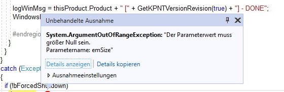

after updating from 5.25 to 8.28 or 9.16 we get the error
"System.ArgumentOutOfRangeException"
Parameter must be greater than Null
Parameter Name: emSize
What's the problem in those two versions?

emSize is often used for Font sizing. It could be going on in a call to TeeChart but there is no TeeChart parameter that I can find with the name "emSize".
If you put a break point in, do you see any TeeChart classes in the call stack? Is there any clue that this is being caused by TeeChart? I don't see any reference to it in the error message.
