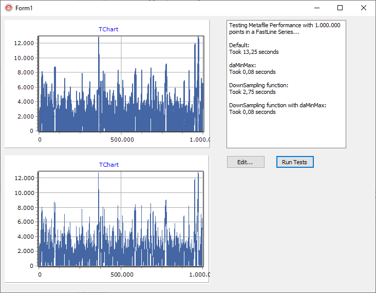

Re: EMF Optimisation for charts
Post by Yeray » Tue Nov 09, 2021 12:42 pm
I've done a simple application to test how the export performs with the "default" TFastLineSeries, setting DrawAllPointsStyle.daMinMax, using a TDownSampleFunction and using a TDownSampleFunction with DrawAllPointsStyle.daMinMax.
As you can see, the TDownSampleFunction is a big performance improvement over the Default TFastLineSeries, but TDownSampleFunction with DrawAllPointsStyle.daMinMax isn't necessarily an improvement against the DrawAllPointsStyle.daMinMax on the Default TFastLineSeries.
MetafilePerformance.zip
(2.34 KiB) Downloaded 1039 times
Post by Yeray » Tue Nov 09, 2021 12:45 pm
rtech wrote:
Tue Nov 09, 2021 12:28 pm
It doesn't seem that TDownSampling function works if series have more than 15000 of points.
As shown in the example above, it's an improvement against using the TFastLineSeries per default. But you won't probably notice an improvement if you are using daMinMax.
Adn how can i use function without second series?
You can't, that's a requirement.

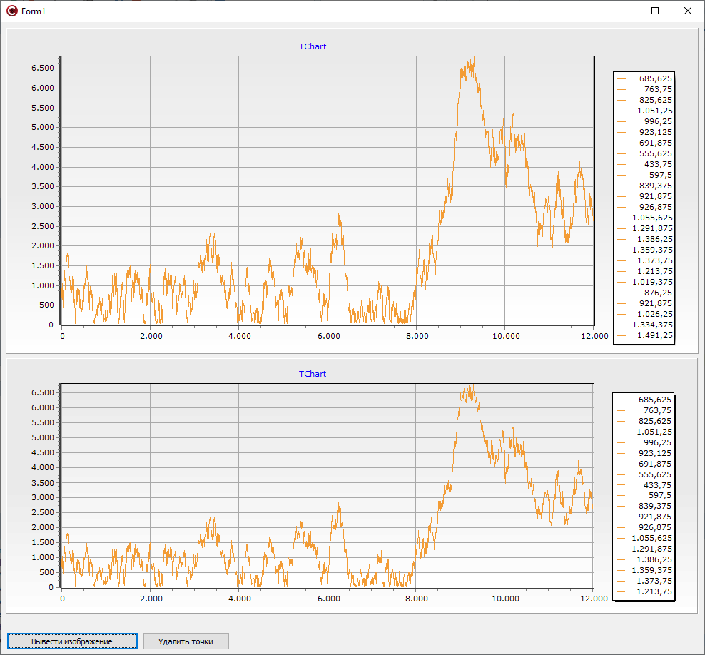

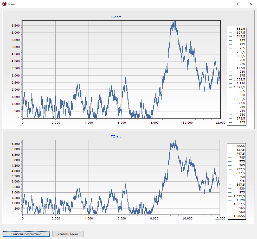

Post by Yeray » Thu Nov 11, 2021 12:52 pm
I've been able to run your project after cleaning the project from packages I don't have here.
After clicking the first button, which generates the metafile below, this is what I see:
Next, I click on the second button to generate the DownSampling function, and I also click at the first button again to generate the metafile again. This is what I get:
If you debug the code, you'll see how Series1 has 1200 points (Series1->Count()), while Series2 has only 3000 (Series2->Count()) while still looking pretty similar
Of course the color is different but it's easy to correct that with:
Series2->Color=Series1->Color;
So it looks correct to me.
