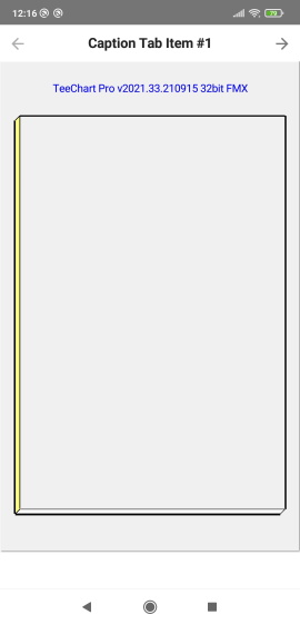

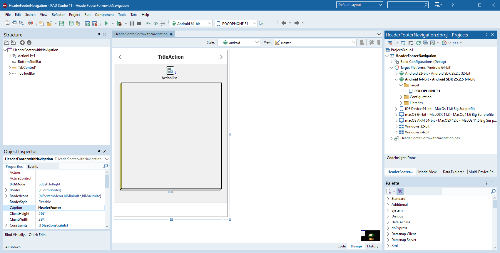

This seems to work fine for me here both with a Pocophone F1 and a Lenovo M10 tablet:

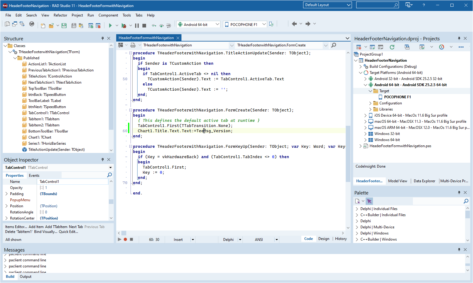

Note I've added the FMXTee.Constants unit and this code at the FormCreate, just to verify the version found by the compiler:
  Chart1.Title.Text.Text:=TeeMsg_Version;

No issues for me here with your project:
