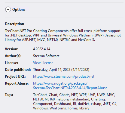

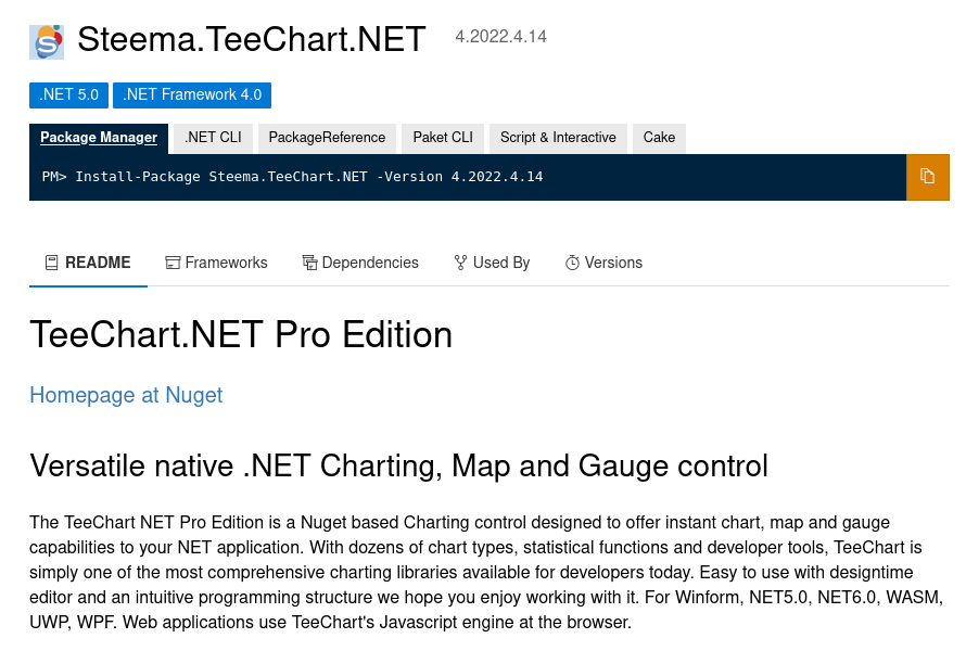

When I look at the package in NuGet package manager, the description says: "TeeChart.NET Pro Charting Components offer full cross-platform support for .NET desktop, WPF and Universal Windows Platform (UWP), Javascript Library for ASP.NET, MVC, NET5.0, NET6.0 and NetCore 3."
Besides NET5.0 I also tried NetCore 3.1, but that doesn't work. I get a NuGet warning NU1701
Package "Steema.TeeChart.NET 4.2022.4.14" was restored using ".NETFramework,Version=v4.6.1, .NETFramework,Version=v4.6.2, .NETFramework,Version=v4.7, .NETFramework,Version=v4.7.1, .NETFramework,Version=v4.7.2, .NETFramework,Version=v4.8" instead the project target framework ".NETCoreApp,Version=v3.1". This package may not be fully compatible with your project.
and the program does not compile (or it crashes at runtime). Do you still support .NET Core 3.1?

There is a mismatch though between what the NuGet package reports in Visual Studio:
Screenshot from 2022-04-20 16-06-21.png (23.53 KiB) Viewed 11982 times
And what our NuGet webpage reports:
Screenshot from 2022-04-20 16-06-45.png (101.83 KiB) Viewed 11982 times
Thank you for pointing this out to us, we'll update them both as soon as possible.
