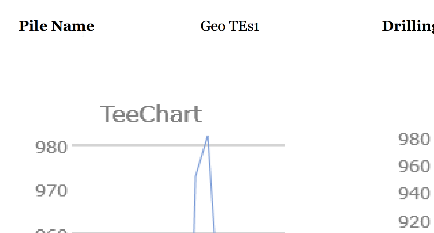

zoom in on pdf generate.
(ctrl + )
you will can see a great difference between legend text and "header text" on first line.
The same issue is obtained with a "scaling" of tchart bitmap export.
Only (worst) way to not blurry image is to printvisual from window (but it depend on window rendering and in my case it's not accepteable).
example_with bitmap_exported.png (38.24 KiB) Viewed 14897 times

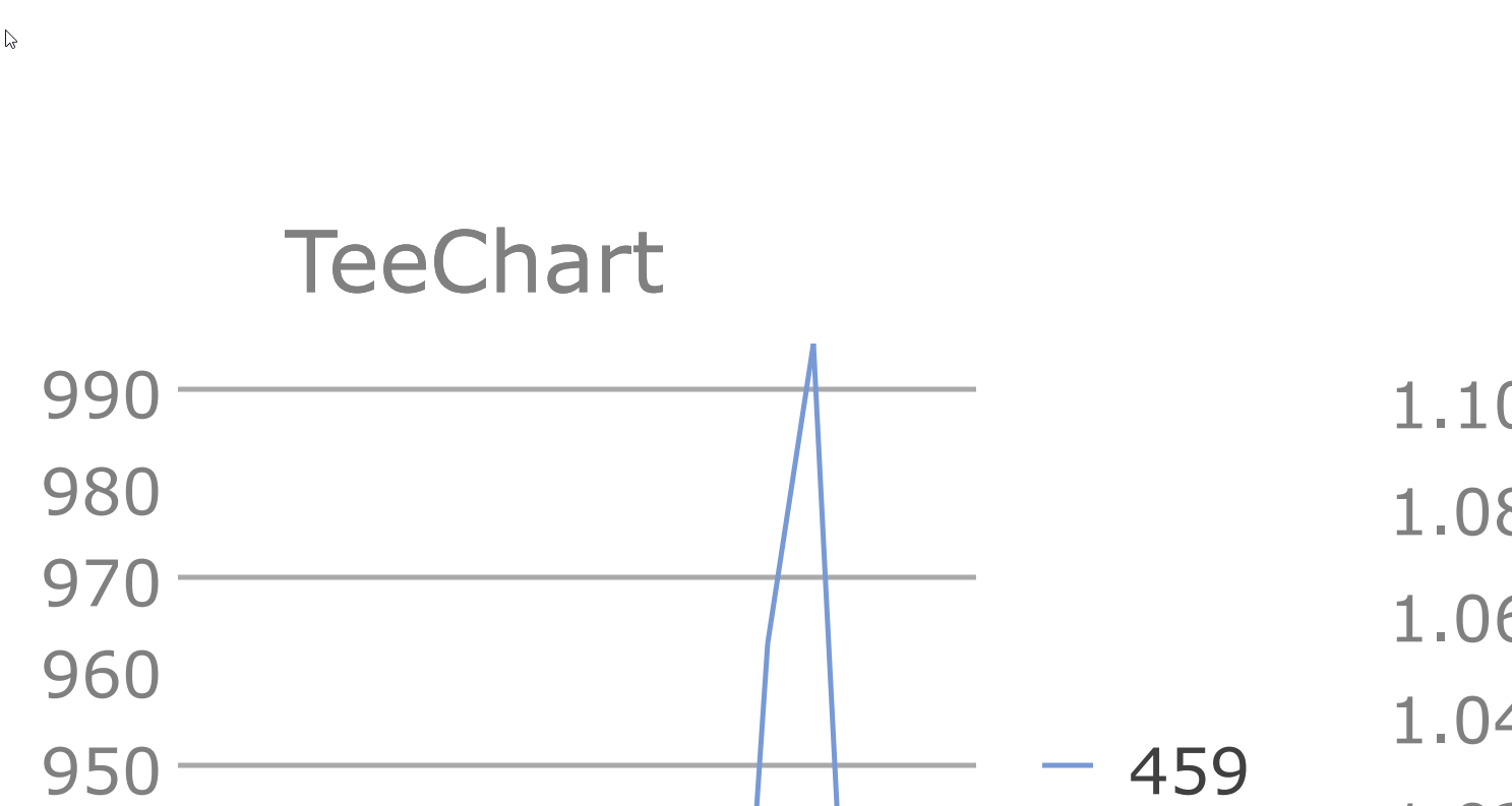

Post by Geomisure » Thu Jul 28, 2022 9:13 am
Hi Marc,
for first option it's not possible.
first size for chart.bitmap(x,y) must be the same of last 2 size parameter. otherwise image is cutted (even if you set stretchmode = fill to image)
for second option i've increased size by 1 unit and R&D manager accept this compromise, however image quality it's visibile blurry against text (an example in attach)
it's possibile to obtain an image with the same quality of metafile obtained in winforms version?
Sorry for insistence but it's the main critical section in out software and must be better quality as possible
Geomisure
document.zip
(270.61 KiB) Downloaded 895 times
Re: [WPF] Teechart Print
Post by Marc » Thu Jul 28, 2022 5:01 pm
Hello Geomisure,
Re.
for second option
Are you referring to the use of this code?
t1.Export.Image.PNG.Save(s1, t1.Bitmap((doc.PageWidth / 3 * 2), doc.PageHeight *  2), doc.PageWidth / 3, doc.PageHeight);
t2.Export.Image.PNG.Save(s2, t2.Bitmap((doc.PageWidth / 3 * 2), doc.PageHeight * 2), doc.PageWidth / 3, doc.PageHeight);
t3.Export.Image.PNG.Save(s3, t3.Bitmap((doc.PageWidth / 3 * 2), doc.PageHeight * 2), doc.PageWidth / 3, doc.PageHeight);
(that gives result like attachment)
If you were using metafile from the Winform application then the quality will be different as it is not pixel orientated, Doing a single export from the WPF charts as a pdf gives you a similar quality output but as soon as it is rendered to bitmap and resized the quality is lost.
