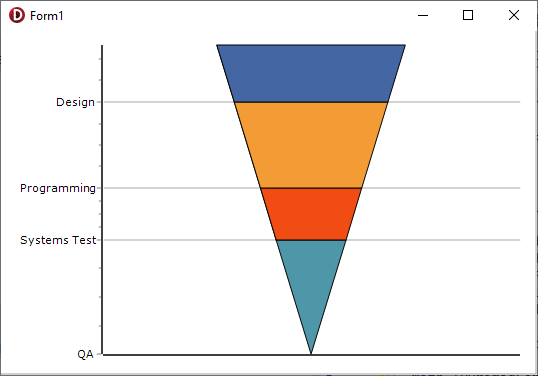

I would like to show the label on the LeftAxis, not values. So in the above case, there would be 4 ticks on the left axis being Design, Programming, Systems Test and QA.
You could do something like this:
uses TeePyramid;
var i: Integer;
    sum: Double;
  Chart1.Color:=clWhite;
  Chart1.Walls.Hide;
  Chart1.Title.Hide;
  Chart1.View3D:=False;
  Chart1.Legend.Hide;
  Chart1.Hover.Hide;
  Chart1.Axes.Bottom.Labels:=False;
  with TPyramidSeries(Chart1.AddSeries(TPyramidSeries)) do
    Add(100, 'Design');
    Add(150, 'Programming');
    Add(90,  'Systems Test');
    Add(200, 'QA');
    sum:=0;
    for i:=0 to Count-1 do
      sum:=sum+YValue[i];
      Chart1.Axes.Left.Items.Add(sum, Labels[i]);
  Chart1.Axes.Left.Inverted:=True;
