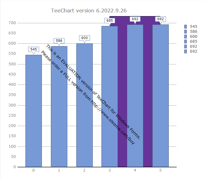

Using the latest NuGet in a .NET 6.0 WinForm app, the following code:
      InitializeChart();
      tChart1.Series.Add(typeof(Bar)).FillSampleValues();
      _ = new ColorBand(tChart1.Chart)
        Axis = tChart1.Axes.Bottom,
        Start = 3,
        End = 5,
        Color = Color.RebeccaPurple
      tChart1.Header.Text += $" version {Utils.Version}";
Renders correctly:
Screenshot from 2022-10-04 10-56-41.png (30.45 KiB) Viewed 11672 times
Does this code work correctly for you?
