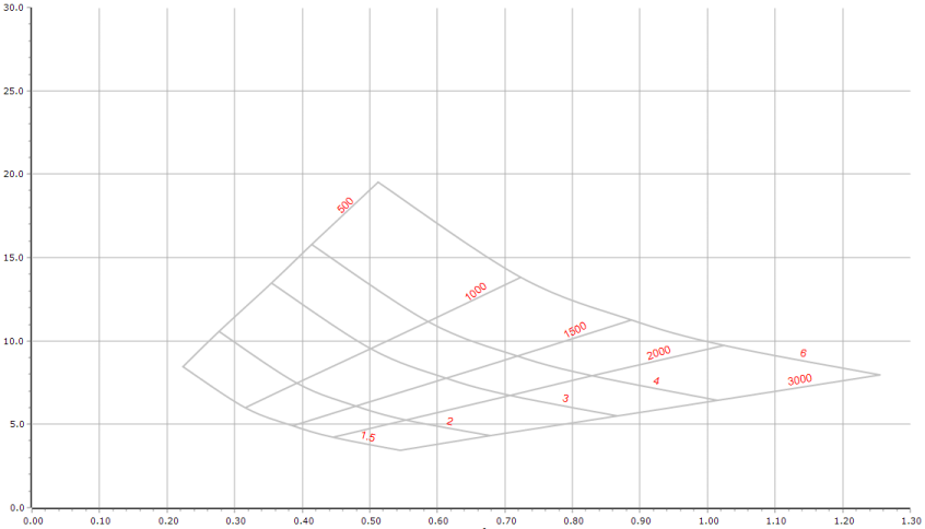

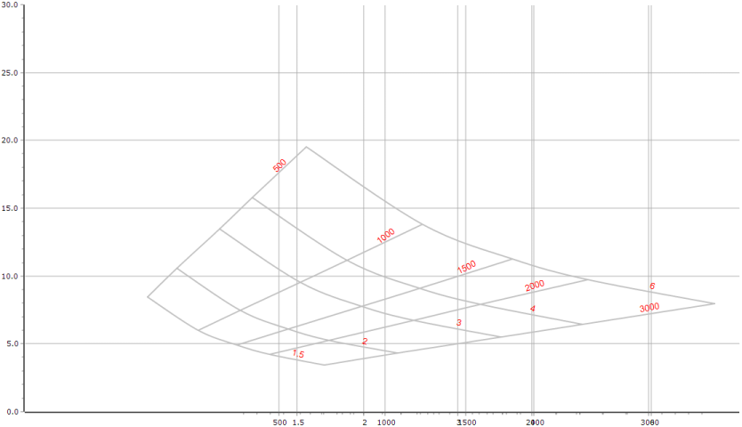

I am trying to build a "Carpet Plot" of 2 intersecting groups of "Iso Lines" with labels on the lines showing the Iso value of the line. As the data grid is based on the 2 Iso parameters, I can't plot them as contours in TeeChart, so I have created a grid of XY Line series. I could not find any way to add a single label to a line series, so I created an invisible grid of single point Point Series and used the point label to display the line Iso value. The problem with this approach was that the point series labels hijacked the bottom axis and I had to tie them to an invisible top axis. See attached screen shots.
My questions are:
Is there a better way to create the Carpet Plot?
Is there a way to add a label to an arbitrary position (preferably in XY coordinates) on a Line Series?
Is there a way to add labels to a series point that does not mess up the XY axis?
