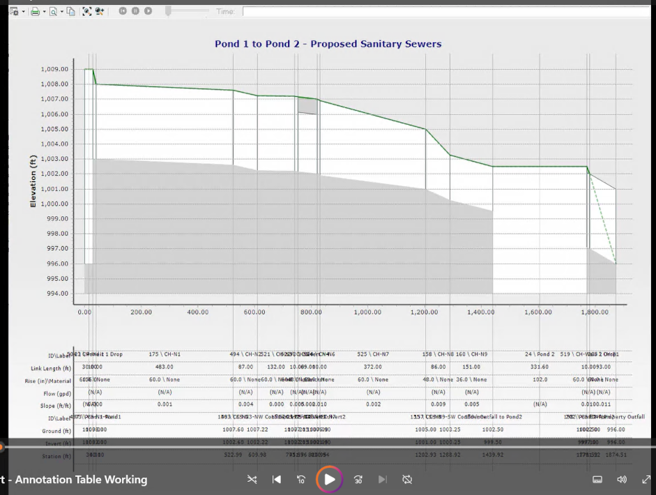

Once the data is loaded, resize the window vertically up and down and watch the text. You'll see the text jump around a bit which is a regression. Also included in the DataFiles folder is a mp4 video that shows our software that uses the TeeChart version from 2009. This version of TeeChart does *not* have the issue. When you watch the video, notice how the font actually gets smaller as the vertical height of the form gets smaller. The text does overlap but that is OK with us. It is better than the text jumping around.

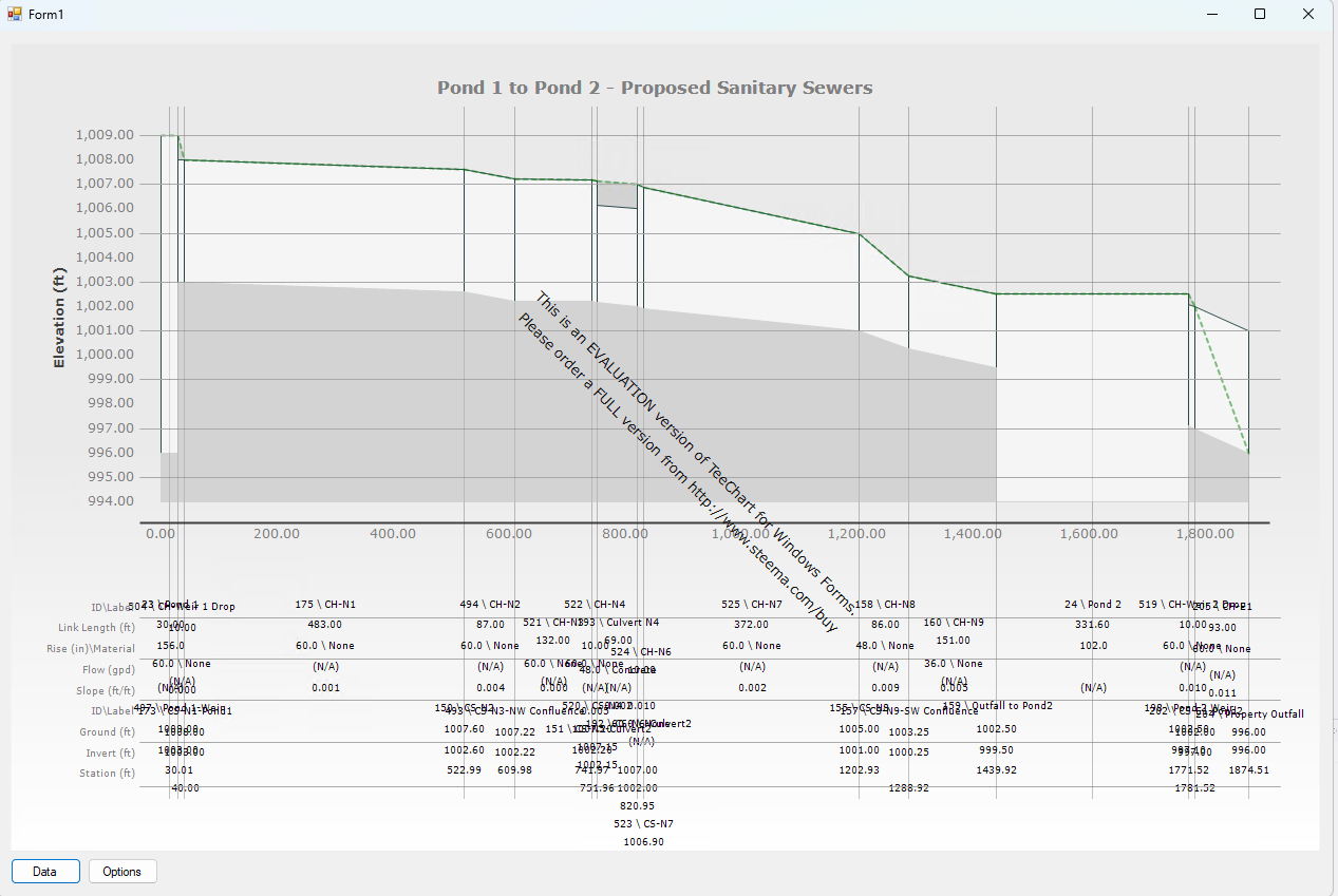

Thank you. Yes; I notice that the Custom Axes labels look quite different to start with:
Screenshot from 2023-05-15 13-34-15_2.png (475.24 KiB) Viewed 64852 times
And:
Screenshot from 2023-05-15 13-42-35.png (121.5 KiB) Viewed 64852 times
Can you explain why the labels are lined up horizontally in the top version, but are not in the bottom one? This might be an important difference.
More generally though, setting FixedLabelSize to false gives some improvement:

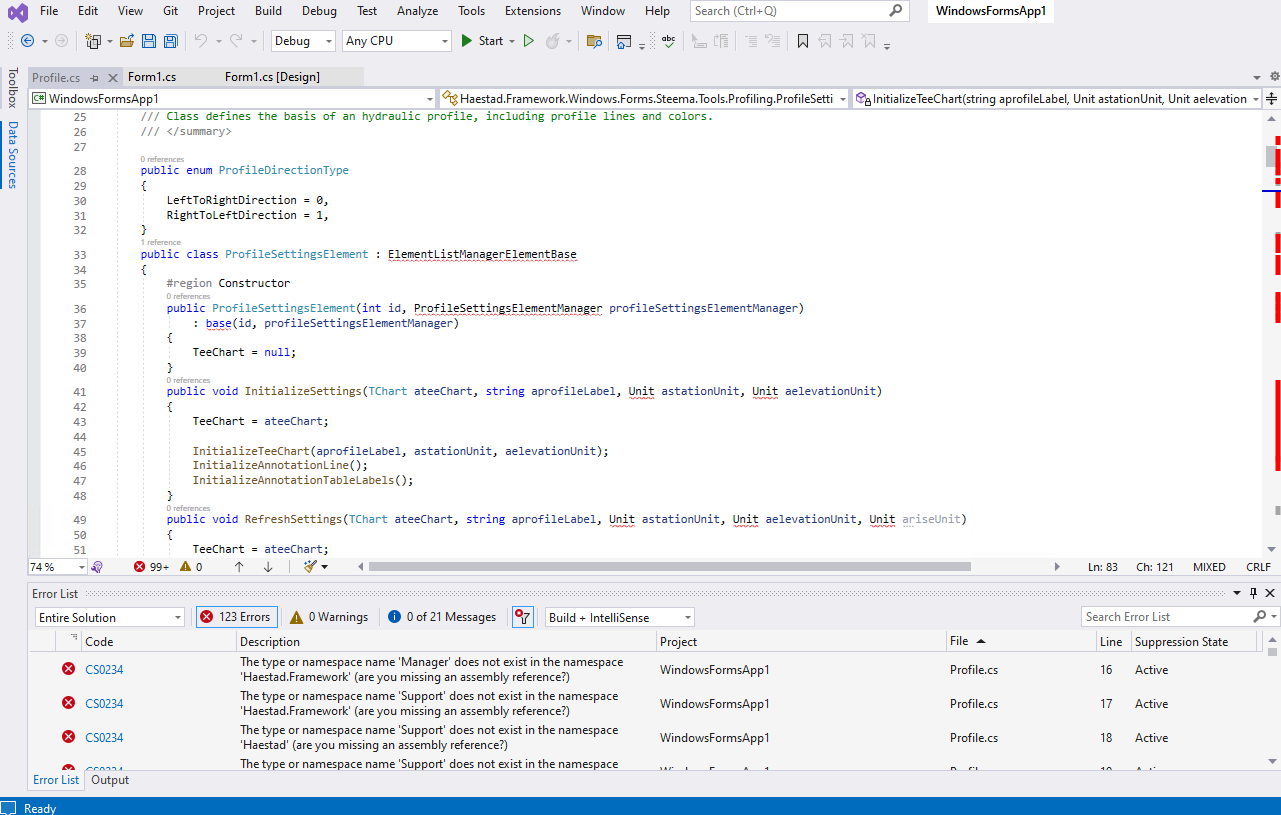

When I try to compile your Profile.cs, I obtain:
Screenshot from 2023-05-16 17-14-57.png (134.93 KiB) Viewed 64821 times
We usually ask for a minimal, reproducible example to speed up our responses to our clients. Is there going to be any way you can get one to us please? If not, maybe you could suggest the best way for us to try and get something up and running at our end.

I asked you for something more detailed in my last message in this thread.
As you can see in the screenshot in it, the example you sent us is not a minimal, reproducible example because it produces 123 compile-time errors when we try to run it.
The example you mention of loading a ten file is not minimal, as it gives us no immediate way to see the difference we encapsulated in our question to you:
