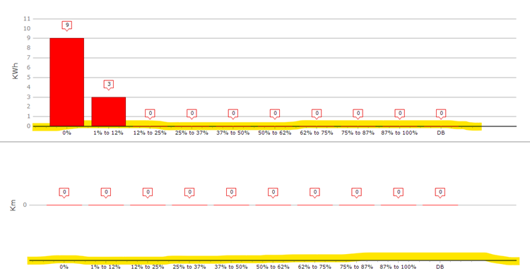

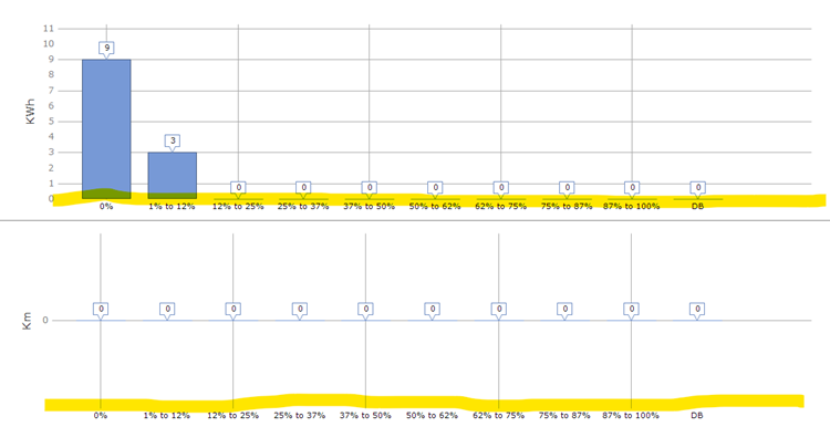

I have encounter the following issue after upgrading my project library from the 2016 to the latest 2023 one. My chart axis delimiter has disappeared, is there a new option to get it back?
2016 TeeChart:
2023 TeeChart:
Thank you.

David N. wrote:
Thu Jun 22, 2023 8:14 am
This is usually the Visible property of the AxisPen, e.g.
            tChart1.Series.Add(typeof(Bar)).FillSampleValues();
            tChart1.Axes.Bottom.AxisPen.Visible = !tChart1.Axes.Bottom.AxisPen.Visible;
If this doesn't work, could you please upload an M.R.E. as I mentioned at the end of this message.
