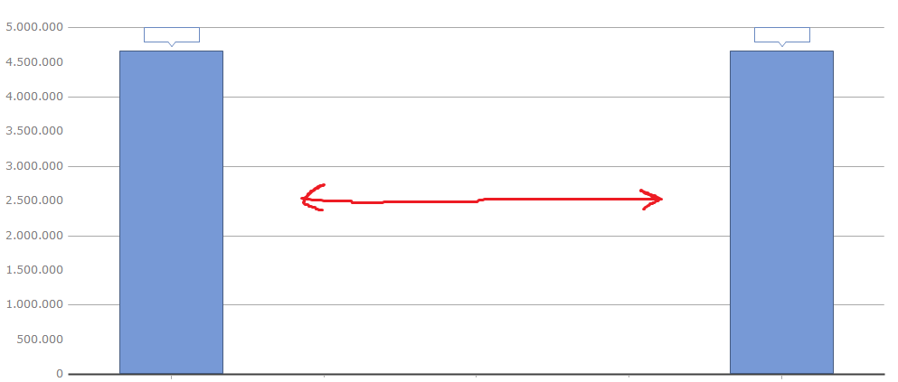

When i plot two bars the separation between them is a bit too much, what could i do to shorten this distance?
How could o control the space between bars independently of how many there are?

This can be achieved by compressing the bottom axis with offset pixels, e.g.
            var bar = new Bar(tChart1.Chart);
            bar.Add(1);
            bar.Add(10);
            tChart1.Axes.Bottom.MinimumOffset = 170;
            tChart1.Axes.Bottom.MaximumOffset = 170;
